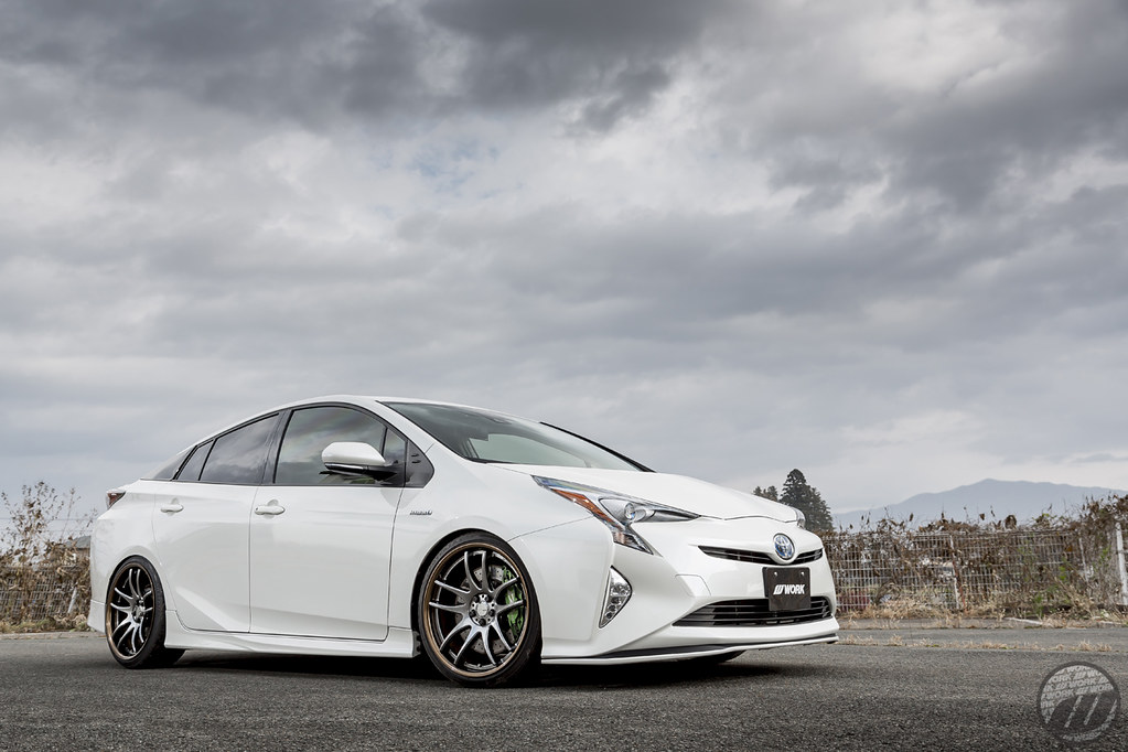

    I didn't know you were only recommending tire rack conservative "normal" people set ups.
    Pictured above are the following specs:
    F: 19x9J +43mm
    R: 19x9J +38mm
    a by 9.5 +43 is the same as a x9 +38 (as shown on the rear) I'm pretty sure if the original poster was considering that wheel he realizes it's semi aggressive. From the looks of it it's not even much of a streach (225 or even 235 or so being the barrel lips aren't even exposed)
  16. Rob43
    Rob43 Senior Member
    Sep 24, 2014
    1,373
    1,050
    VA, BMW Race Car, BMW R1200R, BMW 330Ci, Ford F350
    2013 Prius v wagon
    Look if you're into rubbing, then go for it !
    But face the fact's of your supplied pic, the moment any passengers are put into that car it's gonna rub, nobody likes an ill working chassis that rubs.

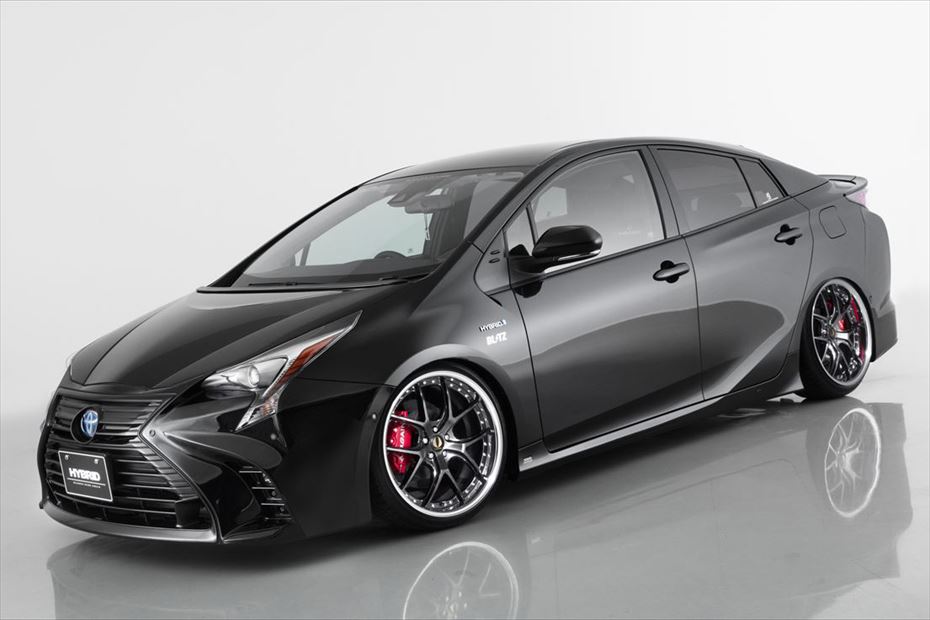

    I don't even own a 4th gen. I'm just stating that one can go much more aggressive if they want. With the right suspension, tire set up, fender roll etc there won't be any rubbing. Of course that's a much more advanced set up then the plug and play conservative specs you are recommending or i'm sure the typical prius own would even want to go thru.
    Just another example of a more agressive set up
    FRONT
    19×8.5J INSET 33(LO) 18mm SPACER INSERT
    REAR
    19×9.5J INSET 31(LO)
  18. Rob43
    Rob43 Senior Member
    Sep 24, 2014
    1,373
    1,050
    2013 Prius v wagon
    Just like I said in post #2; "if you have enough time & money I guess almost anything is possible".
    Having said that, who wants to be forced to run the ridiculous amount of rear negative camber that's clearly visible
    in both of your pics.
    I'd guess that the rear camber on either of these cars is somewhere/roughly at ~neg 4 degrees, this creates all kinds
    of new issues.
    Rob43
  19. Nopho4u
    Nopho4u Senior Member
    Aug 25, 2016
    1,007
    2,061
    Socal son
    First car is stock camber. 2nd car is not.
  20. Rob43
    Rob43 Senior Member
    Sep 24, 2014
    1,373
    1,050
    2013 Prius v wagon
    Maybe it's the interwebs fault, but the first & second chassis looks like added neg. camber.
