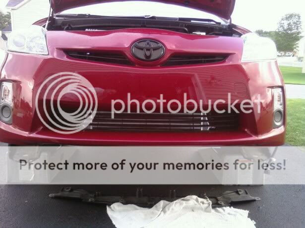

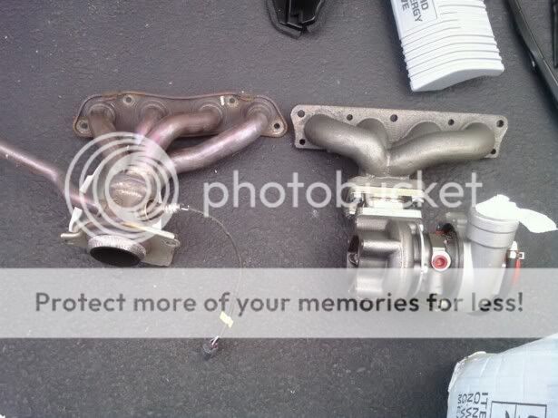

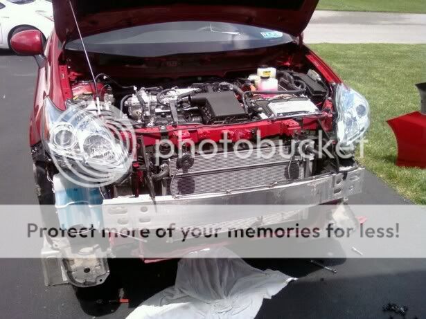

    some stray pics of a turbo prius project I found
