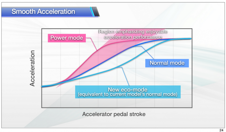

    Again, the driving modes don't change the power available at all. Full pedal deflection is the same in all power modes. The only thing that changes is the pedal mapping.
