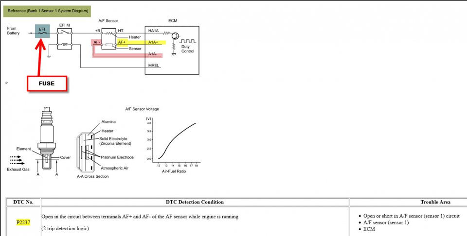

    P2237 is an AF code for BANK 1 SENSOR 1.
    Here's some info. Check the fuse too. The DTC sets when the ECM detects an open between AF - and AF+

    Thank you. Yes, the receipt says Bank 1, Sensor 1. Where would I find the fuse?
