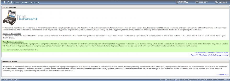

    LINK........................here TIS

    Thanks for providing those pages. I recall that my 2004 ECM and hybrid vehicle ECUs received firmware updates a few years ago, resulting from a TSB addressing driveability issues.
    I still do not see why a used ECM could not be reprogrammed. What is the difference between a used ECM from a salvage vehicle with similar model year, vs. the original ECM installed in a vehicle several years old? If the latter can be updated with the latest firmware, why not the former?
    For that matter, the OP might find that if her car's original ECM was reprogrammed, her problem might go away...
    I understand the concept of reprogramming in order to update the ECM to the latest available firmware, but I do not think this firmware is specific to a particular VIN. Rather I believe it would be specific to a production date range.

    They base everything off the VIN. If the car has an anti-theft system, it's not gonna work with the wrong info.
    Some cars are Federal and some are CA emissions and that makes a difference. Mid year production changes also
    make a difference. Any ECM will need to be programmed with the correct VIN as a minimum requirement.
    Production changes can have a profound effect on internal architecture of the ECM and the wiring harness.
    Pin-outs can change and components can be added. If you plug an ECM into the wrong vehicle, you cold smoke
    the wire harness the ECM and/or both. Like I said. It's not a one fits all and you can't just buy an old ECM
    It's a specific unit for that platform, emissions, production date and VIN.
    The VIN is the key to every vehicle made. It contains all the information required to get the correct replacement parts.
