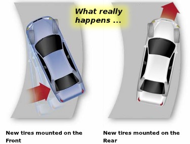

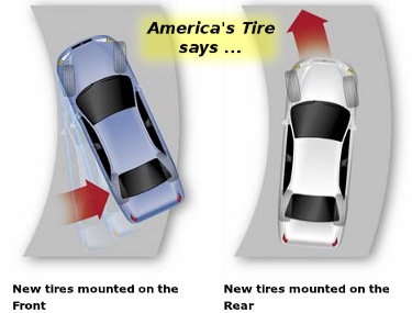

    We had to get two tires recently, after the Civic got a flat. Naturally, we wanted the new tires on the front. That's where steering and braking happens, as well as the drive wheels and most of the car's weight ... so that's where we wanted the newer tires.
    The shop (America's Tire) refused. They said it's a company policy that a new pair of tires must always go on the rear.
    They've even printed up glossy signs explaining their reasoning -- a fancy poster image that is, unfortunately, wrong.
    They show two scenarios. In the one on the left, the rear tires are losing traction, and the rear end of the car is sliding out. That's called "oversteer". The car might spin, especially if the driver has never experienced it before.
    That part's all true. The problem with their diagram is the scenario on the right, where the presumably better tires are on the rear. In their diagram, magically all four tires are holding -- nothing ever loses traction. Good deal!
    But what really happens if you put the bad tires on the front is that if something slips, it'll be the front. That's called "understeer".
    Understeer can be just as dangerous as oversteer. With practice (I recommend autocross!) a driver can learn to detect oversteer and steer out of it before it gets to be a problem. There's an old saying among racers and performance drivers: "Oversteer is when the passenger is scared. Understeer is when the driver is scared."
    Most passenger cars, especially front-wheel-drive cars like our Civic, are designed to understeer severely to begin with. Putting the poorer tires on the front makes that even worse.
    And don't forget the importance of braking. Most of a car's braking ability comes from the front tires. Don't you want your best rubber working for you in a panic stop?
    While I do understand why the default might be to put new tires on the rear -- it's better for inexperienced or panicky drivers -- to insist on it in all cases is just silly.
