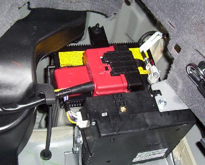

    Bare in mind that the 12 volt battery that normally goes in the Prius is more along the lines of $200.00 from the dealers plus labor to install. Chances are the $125.00 figure is a advertisement for a non hybrid car such as a Camry.
    The Prius takes a AGM type battery with the JIS "reversed" posts which is also vented via a vent tube. It is also a sealed battery.
    Below is a view of what the area looks like with the 12 volt battery exposed.
    The battery is nestled in the right rear corner of this view.
