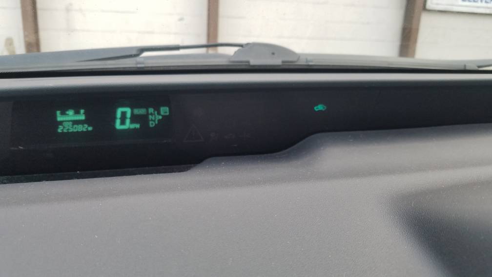

    Can't take credit for the miles but I did contribute 500 of them since I got it more or less. [​IMG]
    SM-G935P ?
    cwerdna and mercat68 like this.
