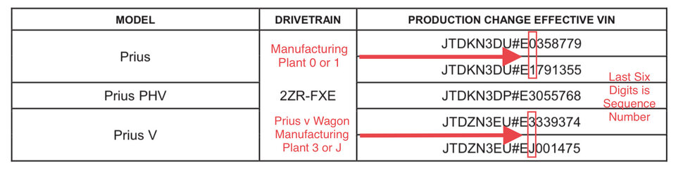

    Not all JDMs have the same issues as a 2010 through early 2014 Prius. Used in Japan gen3 JDMs can be as recent as a 2021 as the Prius v/+ was still sold there until then. However there is no US vin plate to id the year so it's possible any 2010-2021 JDM could be in the crate you receive.
    Since you have a 2014 v, there is a good chance you have the revised pistons and rings. Verify by vin.
    Take your vin and determine which plant (3 or J) it was built in and then determine if your last six digits are higher than that plant's production change sequence number.
    An early head gasket job with existing revised pistons and rings will include an improved head gasket from Toyota or Felpro. A rebuilt head cleans things up in the valve train. Have the shop update the ecu software to 34751200.
    End result is you have a head gasket job with the same updates as a good gen3 rebuild. Assuming you have a first class shop do it.
    You could spend $225 more and include the latest intake manifold as described in the attached tsb. An improvement you don't get with most rebuilt engines.

    Yes! My engine is ...EJ006078, so it's got the revised pistons and rings. This a good thing, right?

    Yes that is a plus especially if it has not been burning oil.
