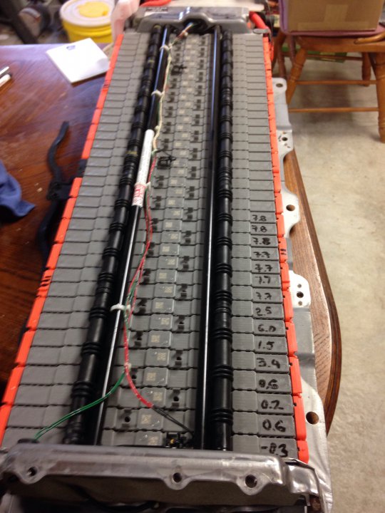

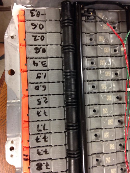

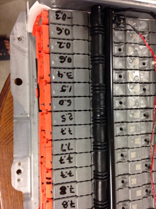

    Hi i'm new here. Just bought a 2001 prius with a bad hv battery. I removed the battery and measure the voltage cell and i have found that last 8 cells are bad and the other 4 are 7.7v the rest are 7.8v. Can anyone tell me what to do? Should i replace all 12 cells or only 8 that are low.

    Your choices:
    • ~$2,300 - buy traction battery from Toyota, swap electronics/modules
    • ~$1,500 - buy Dorman rebuild, $1,000 core charge, swap batteries
    • $?? - buy modules, learn how to rebuild pack, and repeat
    Speculation on my part, it sounds as if an internal short drained the modules on one side of the pack. Alternatively, someone tried to rebuild the pack and failed to balance the modules. Check the module serial numbers and see if there is a break in the order that corresponds to the failed modules. Also, check the sensor connector.
    The battery has module pairs and the voltages are monitored by one connector to the battery control electronics. You want to see if there is any evidence of a problem with the connectors.
    Cook71 likes this.
