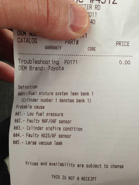

    ImageUploadedByTapatalk1369141752.021361.jpg pretty sure I need a catalytic converter, it appears to rattle quite a bit now that I think about it. Not sure how this relates to the warning lite that has now went away.

    Of all things listed, "Large vacuum leak" raised my eyebrows.

    I am in your area and would be more than happy to help you out. The code p0171 most likely comes from a dirty MAF sensor.. Send me a message if you need help...

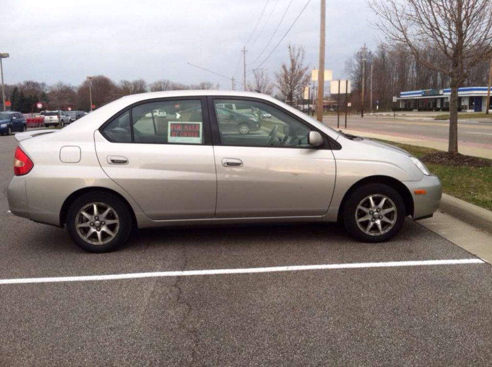

    Thanks for helping out this summer Dave! ImageUploadedByTapatalk1389409913.460111.jpg

    OH,no..sorry to see that happen!! If I can ask what is your asking price?

    That was just a picture I had on my phone from when I bought it. I'm still driving it!
