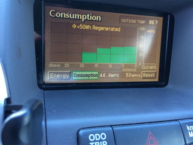

    UPDATE: the good folks at Greentec replaced battery and I intend on driving this 500 miles this week to see what develops. Gas mileage is good again (after taking unexplained 25% decrease), back at 44 mpg on a 70 mph trip (and I have the slightly wide custom tire and wheel- so I think this is good!) ImageUploadedByTapatalk1412020675.992647.jpg
    Code p0420 reared its ugly head again not to be forgotten. Going to drive a little bit and see what develops.
