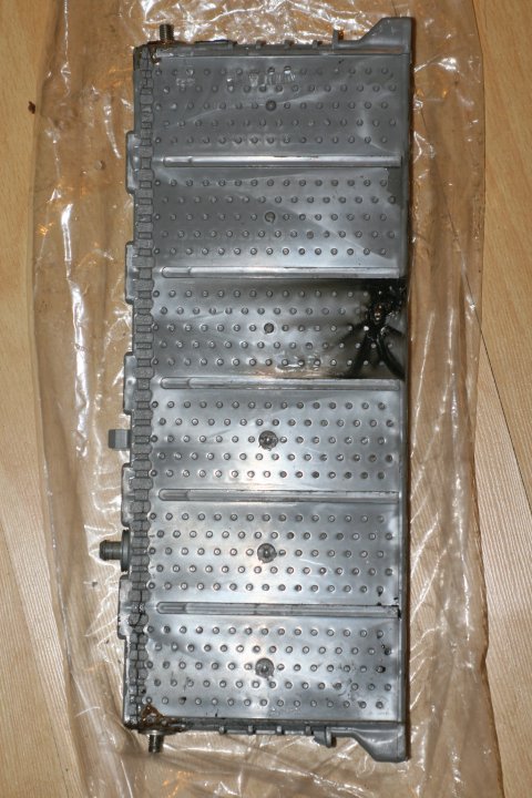

    I received the used cell from Ebay for $40 and took the HV battery out. I was doubtful that one single bad cell could cause all these problems. I took the battery out and put it back all together without any mishaps.
    After taking the bad cell out, I understood why the car ran so badly. The side of the cell looked like it suffered from a mini explosion followed by a small fire as there are black carbon burn marks with a piece of solder inside of the cell exposed and visible from the outside. It partially melted the side of the adjacent cell. After I replaced that single cell, all of the warning lights went off and car runs great getting 45+mpg.
    Amazing how one single cell can make the car almost undrivable.

    Here is a picture of the failed cell. After driving for a couple days, the P3006 code comes up again with a p3076 for abnormal air flow by battery cooling fan so I think I may have to take the battery completely apart and match the cells. In the meanwhile, the car runs fine with 400+ miles driven at 44.2mpg. Notice the crack on the top of the cell on the left and right corners.
