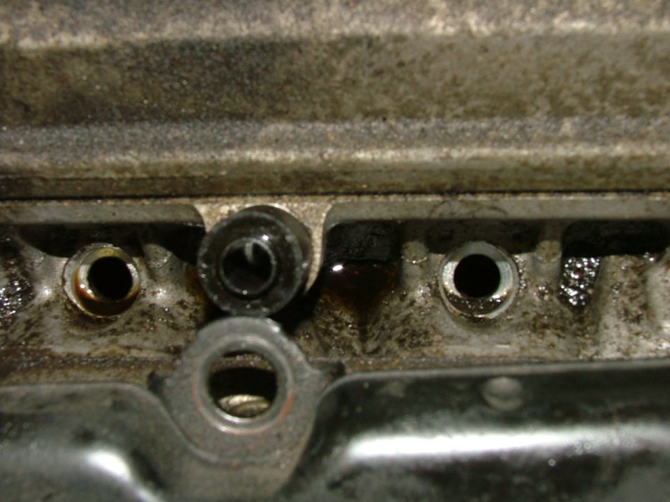

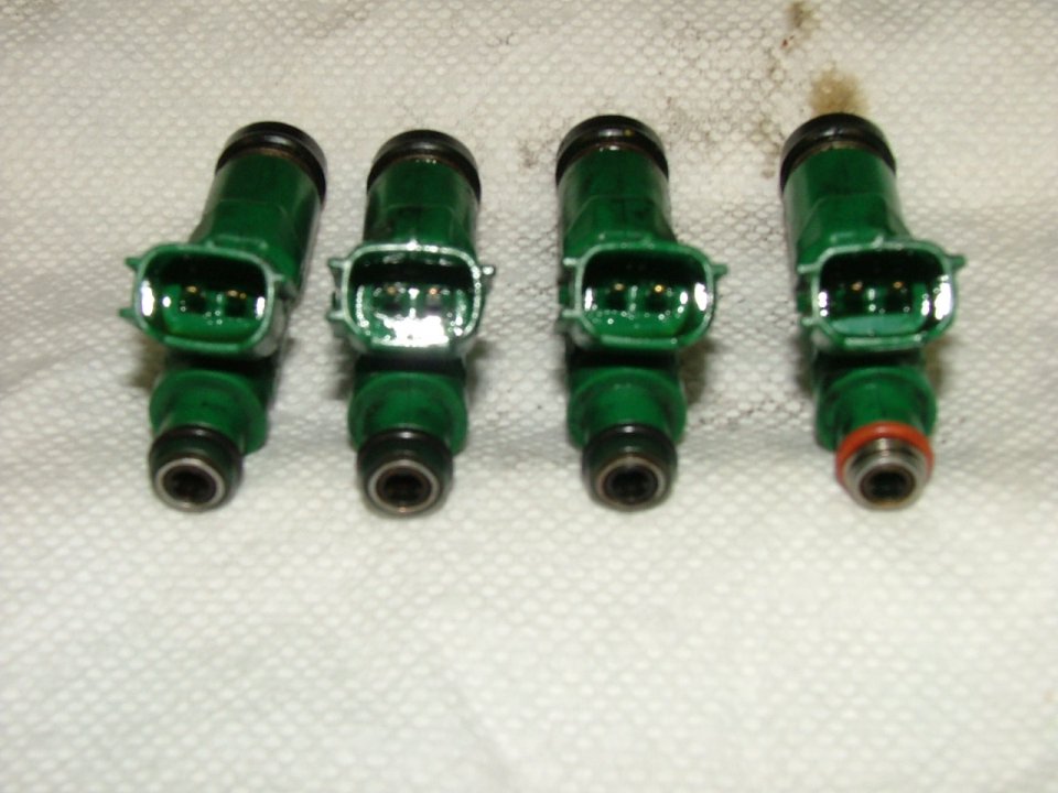

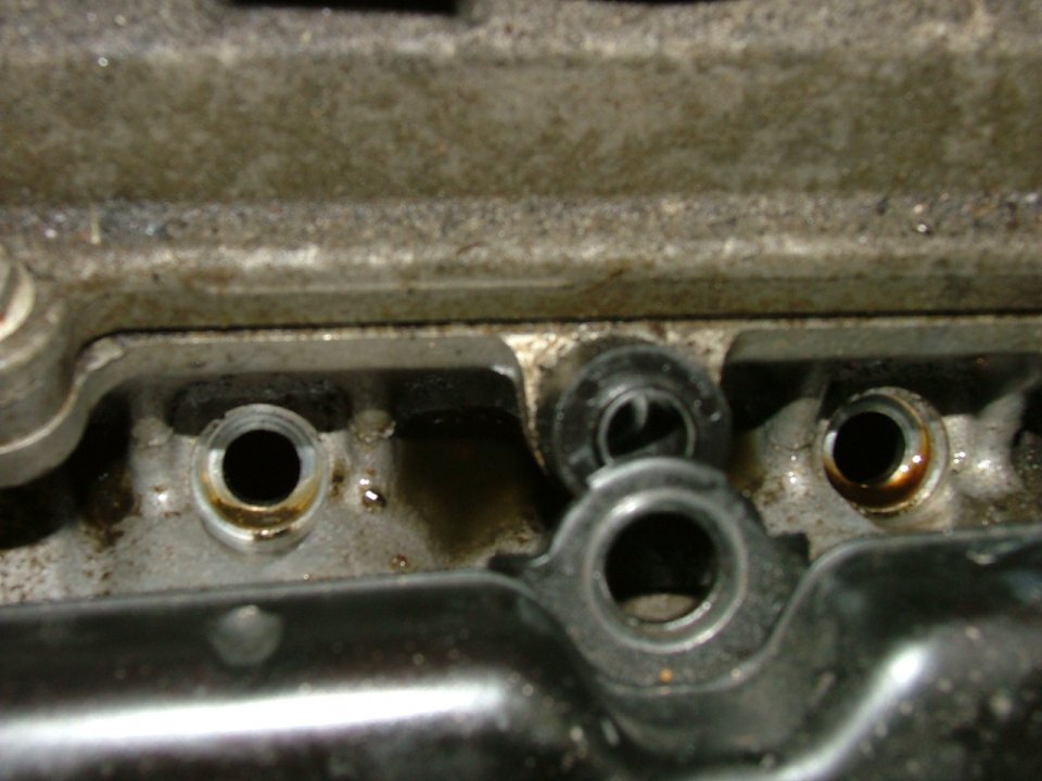

  6. buddy77
    buddy77 Junior Member
    Oct 11, 2009
    23
    Va
    I have read that you can use a long screwdriver with your ear @ the end to id bad injectors as well. There is a $75 tool (EFI quick probe) that does the same thing. If I had read this earlier I would have made an offer on your injectors, but I purchased 4 Denso remans for $90 off Ebay earlier. Appears the old injectors were leaking. When I went to remove them, the area was very dirty & there was fuel puddled around them. Also, they were not Denso....so does this mean not factory....someone has previously replaced them? One injector has a shiny tip with a red o ring. Does that mean anything? As always...thanks for the advice...awesome site! I have some good gen 1 & gen 2 battery cells if anyone has a need.
