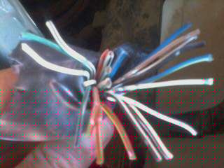

    ok, upon closer inspection of the wires, the color schemes seem fairly straight forward. with the EXCEPTION of
    (4) white w/ black stripes. this seems to be the real kicker of how to proceed next? i didn't download the wiring diagram yet, as i wanted to take a closer look at what i'm dealing with exactly.
    20 wires total:
    (4) large (gauge 14-16)
    (16) small (gauge 18-20)
    large wires:
    (1) blue/white stripe
    (1) white/black stripe
    (1) green/white stripe
    (1) white/green stripe
    small wires:
    (1) brown/white stripe
    (1) black/white stripe
    (1) blue/green stripe
    (1) white/blue stripe
    (1) red/yellow stripe
    (1) red/green stripe
    (1) red/white stripe
    (1) green/black stripe
    (1) green
    (1) black/white stripe ------ taped together (with wire below)
    (1) white/black stripe ------ taped together (with wire above)
    (4) white/black stripes

    do i just need to peel the tape back more for another pattern to emerge on the (4) white/black striped wires? with dots perhaps?

    White with black are often grounds in Toyotaland. Check with an ohmeter from those wires to chassis.

    if the white w/ black are in FACT the grounds will it make a difference which one gets spliced with what as long as it is spliced to another ground?

    No, the pattern should never change on a wire. Always a solid color with a solid stripe.

    Hard one to answer. If you find out where at least one of the White w/Black striped wires ends up, I may be able to tell.

    3 prong Paul seems to think the white w black stripes are grounds. If this is the case does it matter which ground splices with which ground?
  15. FL_Prius_Driver
    FL_Prius_Driver Senior Member
    Jun 17, 2007
    4,319
    1,527
    Tampa Bay
    I
    Theoretically -- No, it should not matter. In reality, some sensitive electronics are susceptible to ground loops. In a properly designed car (like the Prius) this would be unlikely. In your case, the secondary damage from whatever sliced the wires would be more of a concern.
    If you can tell me what any of those wires plugs into, I can ensure that it is a ground and not something else. (I have the same model Prius and multimeter. A quick check for me. I'm going under the hood tomorrow to replace the MAF sensor.)
  16. slimfrancis
    slimfrancis Member
    Jun 27, 2011
    188
    36
    New Haven, CT
    I
    this split is in the main (thick part) of the harness right behind my drivers head light. there is a cluster of 3 or 4 wires that branch off the main harness that plug into the head light. (you can see this in my first set of pics) one part of the harness disappears under mg1 and the other end continues routing behind the radiator. (i think) i'm out of state right now but will take a better look at where the harness is coming from and going to when i get back to the car on monday.

    haha, after looking at the wires it seems pretty straight forward since 16 out of the 20 are all different color schemes. even if i look at the wiring diagram i still don't know how i'll be able to differentiate the (4) white w/ black striped wires from one cut end to the other cut end?

    OK. For that harness, all wires White with Black stripes are ground. If the internet is to be avoided for shopping(?), then use the yellow pages to call various electrical supply places for uninsulated butt splices. Granger may be a good start. If they don't have them, then ask them who might. If your going to go somewhere, at least bring a picture of what you want.

    excellent, thanks so much FL! i will get some uninsulated butt splices and heat shrink and get crimping. i see there's a grainger not too far from me. i'll crimp my 16 and then maybe twist the grounds together before i crimp them permanently just to make sure i don't get any weird ground loops. i'll keep you posted with the results. i REALLY appreciate your help with this.
