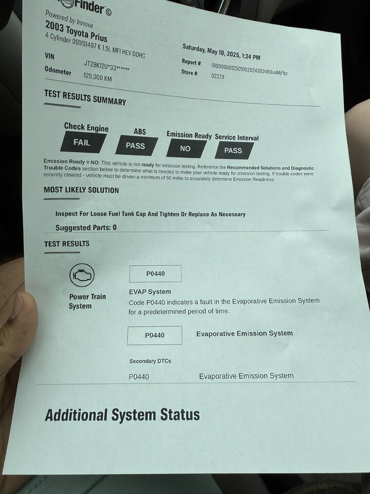

    Fast forward two days later and I get a panicked phone call from my son saying that the check engine light just came on. So I had him go to auto zone and get it coded.
    He said the car is driving fine and nothing feels wrong other than the CEL light. When they coded it the code turned out to be a P0440.
    I guess my question for the forums is if its ok to drive it with that code and emission leak issue for the time being until I can get a chance to look at it or take it to a mechanic or will it hurt the car?

    read through this thread. hopefully, it's just the gas cap:p0440-code-shortly-after-fill-up.86610

    Yep, I think I got this code a few years back due to the fuel system not being airtight with the filler cap on. My fix, which seemed to work, was to plug the filler neck with a rag and lightly sand where the cap gasket sits. Apparently rusting of the filler neck made it so the cap wouldn't seat properly, but maybe a new cap would have also fixed it.

    I just ordered a new gas cap for my ‘02. Part no. 77300-20010. Search the ‘net for best price w/shipping. I ordered mine from Conicelli Toyota in Conshohocken, PA. It’s gonna cost about $33 w/tax and shipping.
