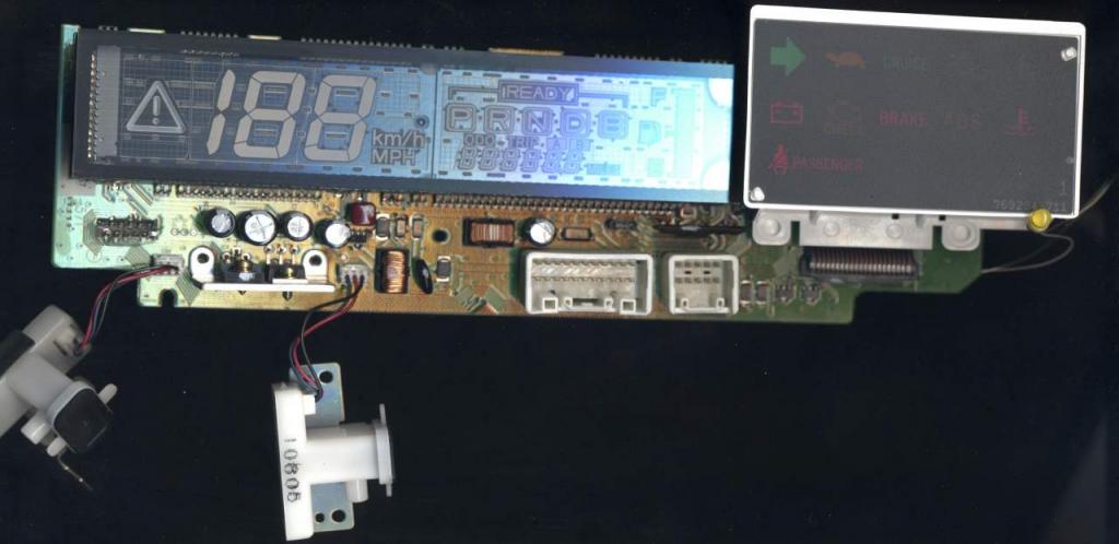

    In later generations, those lights were LEDs, so there would be no need for easy access, so in later generations you would have to remove the whole dash top to get to the meter. Very tedious.
    In your Gen 1, take a close look at the dash top. You will see an outline going around where the meter is. That plastic hood over the meter is a separate piece. Just pull it up. It pops right out.
    Then you see the meter, held down with a few screws. There are also two small inclinometers attached to it, also held down with a couple screws. You can either fuss with the tiny plugs where the inclinometers plug in to the circuit board, or just take out those screws also, and lift the inclinometers out with the meter.
    The white box you see on the right is where your little warning lights go. You can see the check engine is the second one on the second row.

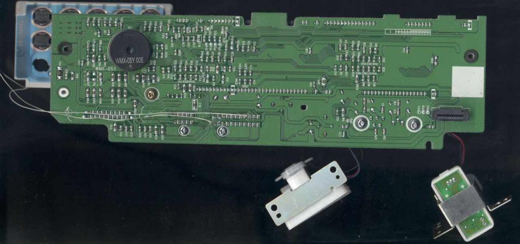

    From the other side of the meter, you see this:
    (Ignore the two little angel-hair wires and the extra LED in the corner ... that was stuff I added.)
    You can see there are little black twisty caps, one for each light bulb; you just twist an eighth of a turn to the left and out comes the cap. The light bulb sitting in each cap is a very common wedge-based bulb you can get at the dealer or an auto parts place. You just pull it out of the cap and insert the new one. Then reverse the steps that got you here.
    It's possible somebody drove the car for so long with the check-engine light on that it burned out. Or they might have just taken the bulb out, to avoid looking at the check-engine light.
