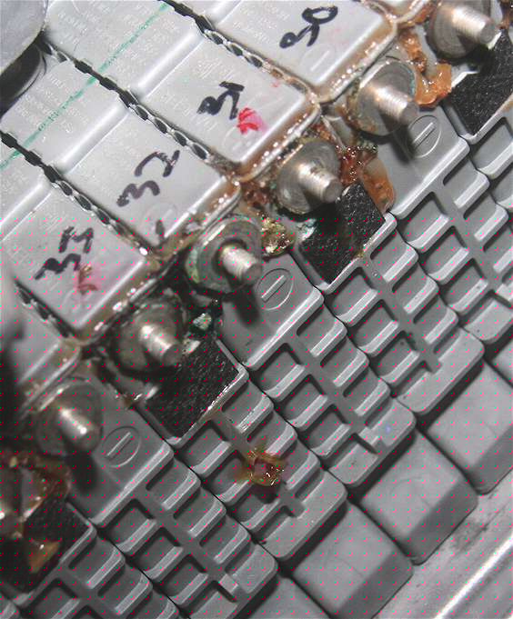

  6. bwilson4web
    29,108
    16,544
    An NiMH battery consists of a nickel electrode, a plastic fiber separator, a metal hydride matrix, and very concentrated potassium hydroxide and water electrolyte (see pri_batt_280.jpg. pri_batt_280.jpg ) When the plastic fiber separator gets too hot, it melts at a spot and that makes a permanent short inside that cell battery.
    In normal operation, each cell goes through charge and discharge cycles (see pri_batt_530.jpg. pri_batt_530.jpg ) During the charge cycles, they get warmer but during the discharge, they hold the heat. Also, a small amount of gas is generated and as the cells get warmer, the internal pressure increases.
    At higher temperatures, the heat and pressure causes some of the gas and a small amount of electrolyte to leak out a terminal (see pri_batt_900.jpg. pri_batt_900.jpg ) To minimize the problem of terminal leaks, Toyota developed a technique using 'glue' and an absorbing pad to prevent a short to ground. But the "O" rings suffer and melt leading to a black, rubbery stain around where the terminal comes out of the plastic case. The little bit of KOH electrolyte 'eats' copper.
    If unchecked, over charging expands the battery case and can destroy the battery (see pri_batt_400.jpg pri_batt_400.jpg ). This is why ordinary 6V and 12V battery chargers and testers are a poor idea. They do not have a sensitive temperature probe or accurate voltage monitor to prevent damaging the modules. The window for failure is very small and the rapid temperature rise and expanding case are only briefly, a minute or so, detectable before permanent damage is done.
    The Radio Control community has been dealing with NiMH batteries for years and developed much improved chargers (see pri_batt_060.jpg. pri_batt_060.jpg ) Prices and capabilities vary but key features are a temperature probe, logic to detect the dV change at peak charge, and a memory to record how much charge was put in and during a subsequent discharge, taken out. This is how I measure the Ahr capacity of modules.
    Now others have also tried to replace failed modules in the traction battery but it has a success rate of 25-33% (see pri_batt_440.jpg. pri_batt_440.jpg ) In this case, two failed modules were replaced but other weaker modules failed soon. It is the battery equivalent of putting new wine in old wine skins. The replacement modules can lead to early failure of other modules, it soon becomes an unwelcome time and money pit. It is equivalent to bailing a boat without fixing the leak.
    In 2004, Toyota came out with an improved module design (see pri_batt_960.jpg pri_batt_960.jpg ) that reduces the concentration of heat at the terminals. With about 700,000 NHW20 cars, 2004-09 on the road, accidents take them out fast enough to provide these improved modules for rebuilding the failing NHW11 traction batteries. But these modules come in all 'states' of wear.
    There are a few shops that actually 'survey' these salvaged modules so only the good and matched ones are equally charged and assembled into good, replacements (see pri_batt_730.jpg. pri_batt_730.jpg ) ReInVolt of Summit North Carolina does this for ~$1,800, not counting shipping. They require the old battery electronics and case, not the modules, to be returned for a core charge, ~$500 (?). But ReInVolt is not the only quality rebuilder but I know they do a good job and stand by their work.
    To rebuild a traction battery:
    • smart RC battery charger that has temperature and dV logic for NiMH batteries with a data recording capability.
    • inventory of modules - to wind up with 38 modules knowing most are already bad, about 19 extra are needed.
    • survey of all modules, find the 38 that at near equal Ahr capacity which takes about 12-18 hours per module.
    • if there is more than a 10% difference between the low and high modules of the closest 38, buy more and keep testing until you have a good set.
    • balance charge all 38 modules using the parallel wire trick or a final charge to the same cutoff voltage.
    • reassemble the battery.
    • enjoy years of Prius service remembering to keep the traction battery away from heat.
    A quality, battery rebuilder does this already using the newer, NHW20 modules. They have inventory, the technology, and the skill to do the job right.
    Another alternative is Toyota will sell a replacement set of NHW11 modules for about $2,200-2,400. It is a simple process to do a one-time replacement of all modules. However, these new modules still use the same design weakness as before. In contrast, the used NHW20 modules have some 'age' but a superior design.
    So you have choices, pick two from Good, Fast, and Cheap:
    • Good and Fast - Toyota replacement, battery pack
    • Good and Fast - rebuilt pack from rebuilder
    • Cheap - do it yourself and resell left-overs
    GOOD LUCK!

  9. bwilson4web
    29,108
    16,544
    * * * Comments inserted * * *
    2: I am not seeing any batts that are more then a .2volt difference although i keep getting a repeat code of P3006, and various other codes of weak battery blocks.
    Other codes?
    3: I did the forced charge and forced drain & then charge like you said Bob, and 17 module pairs went back between 16.52 & 16.5, except the 4 replaced modules which were at 16.25& 16.26v. The total battery pack was operating between 295v and 303 volts at rest and is holding at 301v.
    16.52 - 16.25V = 0.27V :: very close to the 0.3 V that triggers a P3006.
    Sounds like the charge is not equalized BUT if the replacement modules have more Ahr capacity, this too would explain why they show up with a lower voltage after a forced charge. Do they have a higher voltage during the forced discharge?
    In theory, you might be able to re-order the pack putting a 'new module' with a 'weak module' in a pair. The wider voltage swing of a weak module would be matched to the smaller voltage swing of a stronger module. . . . in theory.
    4: Now some things i have to mention
    When i took the car on another test run after i had again thoroughly cleaned all the bus bars and tired to take most the corrosion off, and reassembled and tightened down , i had the pack exposed with no metal cover nor plastic cover & a few bolts so i can get easy access to it.
    Are these P3006 codes coming up during drives versus the forced charge and discharge? If so, it would suggest something is still loose. Are the module footer screws/bolts in? The compression rods tight? Any flex would lead to arcs when driving or under vibration. If you have a rubber mallet, hitting around the traction battery case, possibly just rocking the car, might 'initiate' the arcs.
    First when i started the car a large spark came from the middle of module pairs emanating out of the trunk side connections. I immediately shut it off and rechecked my work which showed correct, so i started again and no sparks, BUT when i went down the road when the car was switching between ev mode and gas, sparks came again, but this time not as big, but still noticeable, not just from the same middle area but from left side and right side mostly trunk side connections, some in the front but smaller. I got the P3006 code multiple times and various weak block codes, and code P1437 came up again which i have yet to address.
    Can you take photos of the arcs? Use the video record option of a digital camera and have someone else start the car and/or have the camera on a tripod and running while you start the car? Later, pull the specific 'arc' frames from the digital video file?
    You had mentioned the control electronics 'were burnt up' and had to be replaced. Now I'm wondering if there may be broken or weak pins in that area. There was a Japanese lady who had a broken pin in a connector and that turned out to be very difficult to diagnose and repair.
    Now when i forced loaded the batts by having in neutral & all electrical loads on, i read voltage readings of the 19 modules as the following:
    All 16 paired mods were between 14.98 & 15.11
    17= 15.13
    18= 14.92
    19= 14.96
    Now during that load test in neutral the car shut down and the main battery light lit up small in the upper right hand corner of the systems monitor.
    I re-cleared the codes, started the car up and put into park and the gas engine came on and off every 20 to 30 secs or so multiple times, this is when small sparks would fly from the rear connections of the battery modules.
    Sparks are bad! It suggests there are leaks to the case. Alternatively, the pack is not mechanically rigid. The KOH and related salts are hydroscopic and the 'arcs' are likely the charge leaking through the conductive path. But any relative motion between modules and the buss bars are going to arc.
    After test driving module pairs 1 thru 17 read between 16.75 & 16.79
    Modules 18= 16.58
    Modules 19= 16.59
    @ rest after the test drive total pack measured 303v
    12 hours later i took a voltage reading of the modules:
    1= 15.93v
    2:15.87
    3= 15.85
    4: 15.83
    5 thru 9= 15.82
    10 thru 15 =15.84
    16= 15.86
    17= 15.88
    18= 15.65
    19= 15.70
    15.93 - 15.70 = 0.23V :: within the 0.30V limit
    Maybe the batts are not good and i just dont know how to read it correctly
    It was so easy for me to see the 4 bad modules as they read under 2 volts, and 1 of them was negative.
    Ok so are the sparks a sign of leaking modules or something to ground, or because i didnt have the plastic covers on them and i was heavily charging and discharging?
    This reads as if there are either loose or still corroded buss bars and/or possibly leaks to the case. Worse, the pack has to be mechanically rigid. Any vibration because the compression rods are loose and footer bolt/screws missing would be bad.
    I know the car toward the end of my 3 mile test drive went into limp mode and jerked around a bit.
    I was thinking if it is definitely the batts and at 10 years old and 122k on them is most likely i would look to get gen 3 batts so i am more sure they would be good ones and not older gen 2 batts.
    You know more about your situation, time and resources than any of us. We can advise but not decide.

    7 CODES DOWN TO 1! I HAVE WONDERFUL NEWS TO SHARE AND A CONCLUSION TO THE P3006 AND VARIOUS OTHER WEAK BLOCK CODES!!!:)
    OK First, a big thank you to Bob, Jeff and all others who have posted, i feel like a young jetti coming up the ranks with very good teachers.
    CORROSION CORROSION CORROSION, as well as not properly tighten down nut to battery posts.
    I thought i had cleaned the wiring harness well enough but i was dead wrong. My first 3 cleanings were only superficial at best. I had initially scrubbed with a tooth brush and baking soda, then followed by a scrub with alcohol with a soft small wire brush. This took some off, but not nearly enough, to have proper connections. That coupled with various semi loose nuts on the post of the batts had caused all the P3006 codes, all the various P3011-thru P3029 codes, all the sparking and arcs, all the sleepless nights and me scratching my head as each battery tested good from my first load testing(which i know was heavy on them, but praise God, did not damage them) to the 2nd load testing (which was done by taking out both my headlights, wiring them in paralel and putting them and a volt meter on each cell for 8 seconds measuring: resting voltage to start of load voltage to end of load voltage, whew a prius aware scanner would be way easier!!)
    Now the real cleaning came when i took each copper bus bar out of the plastic housing (easy to do with a thin flat head, and for the sensor tabs just being careful when removing those( theirs a small tab on top of each sensor that can be pried out off the plastic housing carefully) And sanding down each coper bus bar till i saw copper!.
    I posted pics so one can see the difference in the wiring harness cleanings.
    So with all those nasty codes out of the way i am left with 2 things to tackle and some questions:
    1: Anyone got a fix for P1437 ( in the forum i saw it was some type of vacum code?)
    2: How do i improve my MPG, its down to 36 and i know it could be better. Maybe just things to do, check, etc... that would get that higher.
    3: Bob, Jeff, anyone else can you weigh in on this for me: So with the load test figures i already posted and the 2nd load test figures of resting voltage anywhere between 7.88 to 7.74 then to most module beginning load testing voltages of 7.70 down to 7.60, with a few modules beginning load testing from 7.62 down to 7.50v. Is there a way from such figures, plus the mileage (122k) plus the years of batts (10 years) that i can understand how much life expectancy is left in the modules?
    Would MPG have any play in the posted figures above (like if they would new batts would the resting voltages etc... be higher and the load voltages would not go down as much?)
    4: Would it be worth investing in that DC6 charger and charge/discharge / charge to extend battery life expectancy?
    Ok Thank you all especially Bob for all the helpful posts!!!
    Look forward to hearing from you &
    YES ANOTHER PRIUS CHAT SUCCESS!!! ;)
  12. bwilson4web
    29,108
    16,544
    As long as the greatest dV between the lowest and highest is less than 0.3V, you are 'OK' for now.
    Long term:
    • corrosion source - is probably leaked KOH. I'm sorry I didn't mention this but IF you have to go back and clean the buss bars again, be sure and wipe/neutralize any residual electrolyte on the modules. One of the things ReInVolt does is nickel plate their buss bars since nickel is relatively immune from KOH. Gold plating is another, more expensive option but only if you need to fund retirement later. <GRINS>
    • Prius-aware scanner - there are things other than batteries that can go 'boink' but it really would have made your battery exercise . . . a little more insightfull
    • do not be surprised if another battery problem shows up in 3-6 months - if you get past this infantile failure point, you probably have years of service in the future. Most of the single-module replacement failures were reported with 6 weeks to 3 months. If you make it past this time, rest easy.
    GOOD LUCK!

    7 CODES DOWN TO 1!I HAVE WONDERFUL NEWS TO SHARE AND A CONCLUSION TO THE P3006 CODE!!!
    Ok Bob Gotcha on that, i dont have access to nickel coating, what about a thin layer of vaseline on all connections?
    Now onto:
    1: Someone told me a prius aware scanner for like $35 on ebay, he called it TIS, do you know of this?
    2: Any insights on P1437, or should i just scour the chat forum?
    3: Would a DC6 charger and cycling the batts extend the life of them?
    Thanks Bob!
    J

  15. ChapmanF
    28,740
    19,038
    Also, in case it hasn't been mentioned before, the KOH electrolyte is strongly alkaline already, so baking soda is not the first choice for cleaning up and neutralizing it. (People do use baking soda for cleaning up lead-acid batteries, since their electrolyte is, well, acidic.) For around the traction battery, Toyota literature specifies boric acid, and I've heard of people using vinegar if they have that handy and not the boric acid.
    By this point, your corroded-then-burned-then-baking-sodaed-then-alcoholed-then-sanded bus segments will probably hold for a while. and you might be able to think about just ordering replacement bus bar assemblies. Even if it's a pain to get them delivered to where you are, maybe you could have them on hand by the next time you have a reason to go into the battery. If you look around this forum for the old TSB on battery terminal resealing, it gives the order number for a parts kit for that job, which includes all new busbar assemblies and a few other goodies like resin endplates that weren't in the original design. (In other words, their TSB instructions were always to unconditionally replace the busbars, even though the batteries were only a few years old when the TSB came out.)
    I don't know whether ReInVolt would sell you their nickel-plated busbars a la carte, but it might be worth contacting them to find out.
    -Chap
    Andyprius1, yotatoter and bwilson4web like this.
  16. ericbecky
    ericbecky Hybrid Battery Hero
    Mar 12, 2004
    4,452
    3,359
    Madison, Wisconsin
    You can get a set of bus bars from online parts houses or dealers. Often a better option than dealing with used ones.
    Also, I have customers that use and aftermarket full-pack charger that costs ~$1,000. It can help keep older packs alive.
    But ultimately, at some point a different pack (rebuilt) may be necessary.
    There are other companies out there that we use (Like Adopt a Part) that also have rebuilt packs that are tested and warrantied.
    bwilson4web likes this.
