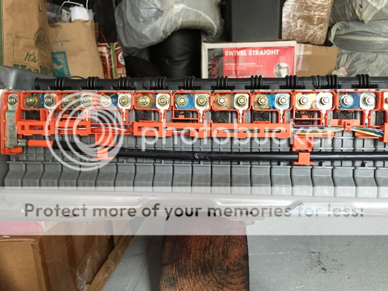

    Where did you get the bus-bar? Also, the car would run before I replaced the single cell with lower voltage, now it won't even attempt to start.

    Oh my gosh.... could leaving the bus-bar unplugged on one side cause my problem?
  3. DRACO
    DRACO Member
    Nov 28, 2015
    362
    78
    Rancho Palos Verdes, California
    2002 Prius
    Oh yes, but I would still change the front bus bar so you will not have future issues and clean that rear bus bar
    I used a wire wheel on the copper tabs and soaked the nuts in electronics parts spray in a cup. Tabs just pop out
    Point is to get rid of all green patina
    You can get it on eBay or dealer

    Just be very careful of those sensors, they are ridiculously thin and brittle
    Try to get some contact cleaner down the wires if you are going to try to clean the front bus bars
    Please remove bus bars to clean and take this opportunity to static test those supposed dead cells, I bet they are fine

    For the heck of it, hand measure the voltages on every module of the first 5 blocks.
    Just want to be sure there is not a short in one of the first few modules
    Then buss bar and connections for #3 should be inspected and cleaned.
    You see how in your techstream reading it reads the first few Blocks
    Block 1 = 15.30v (module 1, module 2)
    Block 2= 15.37v (module 3, module 4)
    But then the next block is only like half the voltage of a normal block
    Block 3 = 8.37v (should be module 5 and module 6)
    And then the readings drop off to nothing, basically. (under a volt)
    So it's like the power can't get through after Block 3 (module 5).
    edit: And if it were me, I would replace the wire looms for both sides. The money spent would be worth the peace of mind of knowing all the wires and connections were free from corrosion.

    Remember use BRASS wire wheel Steel will eat the copper tabs. Use Eye protection and gloves.

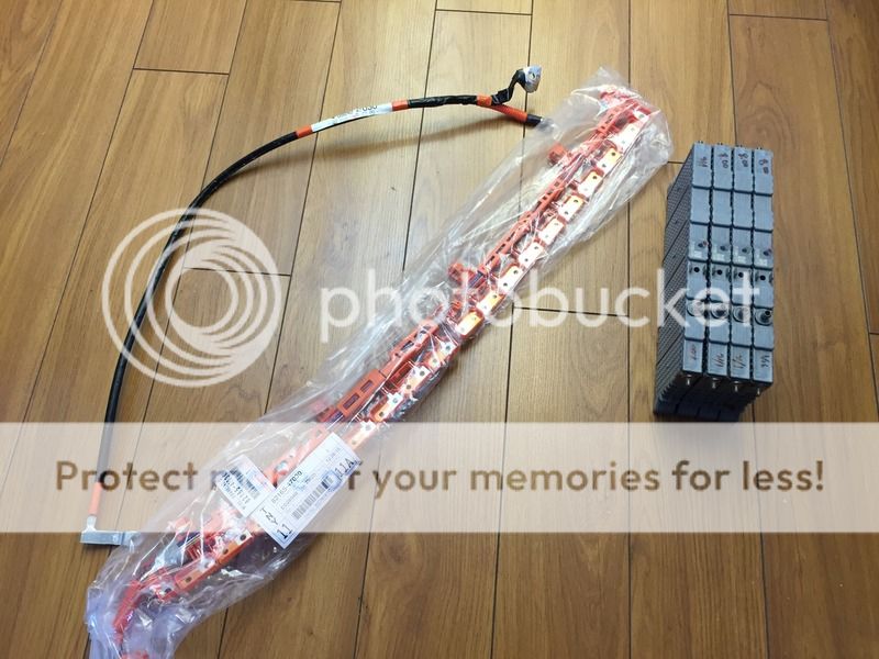

    It probably not the buss bars, it is the wiring/ring terminals.
    I bet you could aggressively probe them and figure out the bad one(s).
    It's likely corrosion crept down the wiring itself.
    Replace the looms. You will get new wires and new buss bars.

    Probe with a firm, nonconductive stick for example. Move them around enough to confirm that there are not breaks in the wires.
    Yes. The loom is the entire assembly of the orange colored wires.

    Leaving that plug undone is what caused all the low/zero readings.
