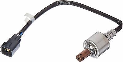

    New hope I put this in the right place:
    I looked and got different part numbers the dealer gave me part # 89465-47050 which is discontinue.
    One post used part # 89467-47010 for a 2004 anyone have a part # that worked for the 2003?
    Thanks in advance, Dale

  3. Dale Royer
    Dale Royer New Member
    Mar 30, 2025
    Maxton NC
    2003 Prius
    That looks like it, you referred to it as rear. I need the Front or some call it upstream.

  6. Dale Royer
    Mar 30, 2025
    Maxton NC
    2003 Prius
    89465-47060 is nowhere to be found, anyone know of a replacement?
  7. dolj
    dolj Senior Member
    May 14, 2012
    8,652
    4,403
    Wellington, New Zealand
    The eBay link in post #2 seems to still link to an active auction. 2002 should be okay for your 2003 car, but a question on the auction will confirm that for sure.
    What diagnostic procedure led you to conclude you need to replace this sensor?
