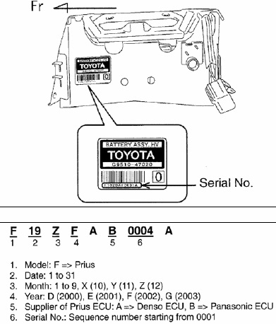

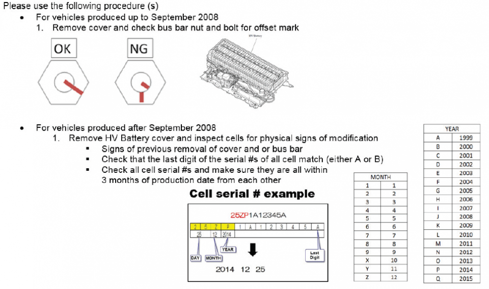

    Remove the metal cover, on each of the modules locate the small "white colored" serial numbers, all 28 should be in numerical order.
    Take a photo of a module serial # and post it in this thread. Or use the helpful "date decoding" images (below) that @TMR-JWAP shared.
    The same large metal cover should also have additional OEM stickers, including one that has a serial #, if you need help post a pic here.
    Battery Pack/Case decoding:
    Individual Module Serial number decoding:
    priusrust likes this.
