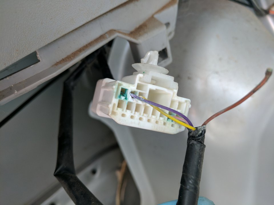

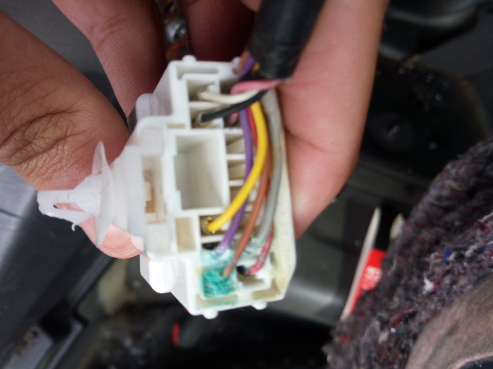

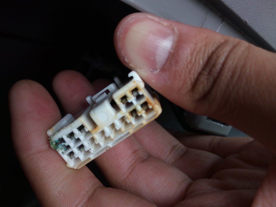

    UPDATE to a solution I eventually came across for my situation causing these codes..
    I had a myriad of dash lights lit for over a year and went through quite an odyssey with multiple 'repairs' that were dead ends. Fortunately the car drove fine the entire time. I swapped out the main HV battery, 12Vbattery, cooling fan, ABS relays, and misc other parts with those from another prius. Thank goodness I had access to that other car or it would have been $10k worth of parts!
    Anyway, the Red Triangle Exclamation, the VSC, and the (!) lights were all lit. Codes for the main battery, ABS, and hybrid control were activated. P3000, P0A84, B2799, and some other intermittent codes. Dealers of course kept saying the main battery was bad and wanted to replace it for thousands of dollars.
    Ultimately the problem was simply a CORRODED CONNECTOR in the electrical wiring harness connector plug. In the right rear part of the car near the 12V battery and blower motor. Some members of this thread had suggested loose or corroded connections as the culprit and they were absolutely correct! Thanks! This is a relatively common problem and can throw codes that have absolutely nothing to do with item referred to in the code (like VSC). So when you get these codes, don't always assume the main battery is bad (even tho the codes indicate that) and spend the extra time tracing and inspecting/testing all the wires and connectors that you can reach when you are making these repairs. In my case it was ultimately simply a $5 repair. Since I experienced this, I have read numerous cases of others having the exact same corrosion issue in the same place. I hope this helps others in a similar situation!

    How about a photo so that we can understand the exact location of this connector?

    yes spme photo so that we can understand the exact location of this connector

    To everyone that wants to see what a corroded connector looks like.
    Here you go.
    HV battery cooling fan fault and fix | PriusChat
