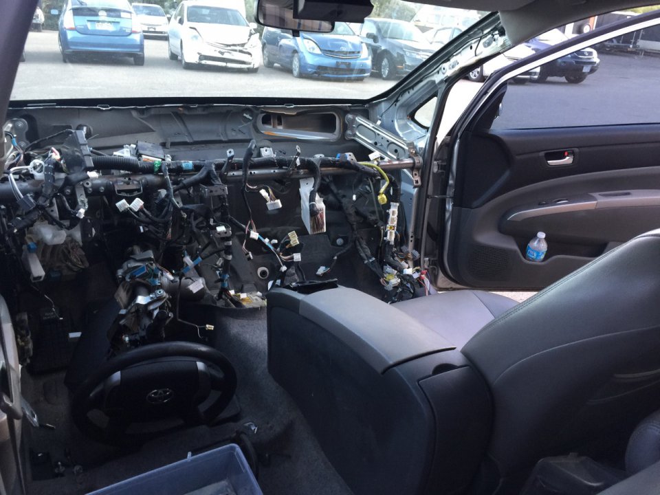

    Take it a well known car ac shop. They will charge it up with dye and find the leak. Leak in Evap coil under the dash is very very common on this car plus whatever you destroyed with your can of kill juice.
    Recently had my evap coil replaced was $1100.

    Great price if that included labor, since they have to take the entire dash apart to do it.

    OMG i saw it there was nothing attached to the bulkhead engine firewall. Everything came out. Big job yes i was surprised that's all they charged. I gave them 5 days to do it. Would have given them more if they asked. So freakin hot down here.

    Typical design. Friday had a Honda Pilot dashboard out. Today it's a Jeep Liberty.
