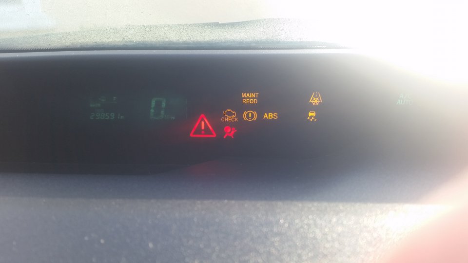

    I'm having the same problem. Just got a 2004 prius. The previous owner said i need to replace the battery. My uncle bought a "refurbished" battery that has a warranty for 3 years for 3k. The mileage i guess is over 200k. Whenever i turn it on maintanence reqd is lit on (the other signs too). We had it oil changed and the filter too. There are times when i try to accelerate it and it wont just go higher. It scares me on the freeway (sometimes i only run 40mph). I try to release the gas then step on it again harder. It would work at times. But sometimes it will really take awhile to go higher. When i try to accelerate on steep road i always get stuck on 10 mph. Its just really hard. Then there are times the the car starts jerking when i brake. Pls help! Thanks

    Thanks for the information! My uncle got it from her niece. He didn't pay for it. He just replaced the battery which caused us 3k.
    How can i find the diagnostic code?
    I will try to manually reset it today. Yes i am flooring the gas pedal hence still no acceleration on my speed. It scares me alot!
    This is what shows on my dashboard when i start the engine
    #5 Maria Navarro, Oct 7, 2014

    It sounds like you did.
    However, the picture you show above, the Ignition is on. Since you are new and unfamiliar w/ a Prius Ignition system, here it is simplified like a traditional car.
    Foot OFF Brake, press Power Button once = Accessory (radio can be turned on)
    Foot OFF brake, press Power Button again = Ignition (this is what you did for the picture above; power windows can be open/closed)
    Depress Brake, press Power Button again = car is Started (The car is now started and ready to be driven. "READY," will be illuminated on the Dash. You can start the car right away by depressing brake then press Power Button.)​
    Read the owners manual to become more familiar w/ the car. If you don't have it, download it from Toyota. LINK
