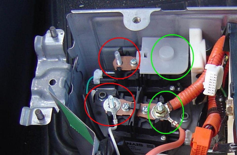

    But not only along the battery could we have this problem of shorting out. There are high power cables that run back to the contactors and BMS stuff at the end of the battery. Now as long as the contactors aren't closed (either because the 12V is connected and the car is turned on or because they are stuck down) there shouldn't be any voltage past them into the place the main HV cables plug into the battery itself from the outside, except for 10 minutes or so after turing off the car due to capacitance, as @2k1Toaster brought out.
    However, where ever the cables come in will have high voltages. (Pic from another PriusChat member.):
    But the service plug (terribly drawn) should separate those components a bit. There still is a chance of shorting out on the cables connected to the contactors, service plug, battery, bus bars, etc. But the voltage is less now. Plus one half is now no longer in an electric circuit with the other half making some of things no longer shortable without making two shorts.
