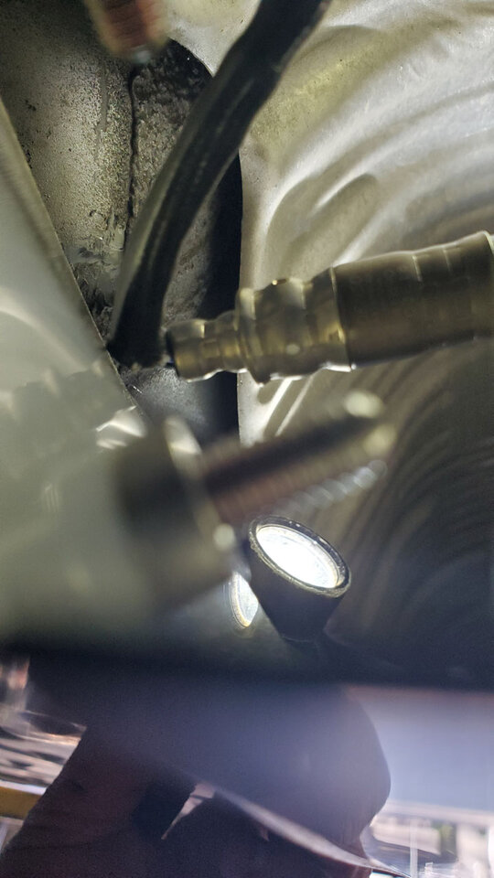

    I was able to see how the mechanic installed the MillerCat on my Prius, and it seems he didn't feed the o2 sensor wire through the notch correctly.
    Photo #1 shows a correct install from the MillerCat website. The wire is supposed to be fed through the rectangular notch as circled in blue.
    Photo #2 shows my installation, circled in red. The wire doesn't go through the notch.
    Photo #3 shows how my o2 sensor currently looks inside the cat shield. The blue and white wires are bent because it's a tight fit, but are not touching the side of the shield. There's no metal on metal that I could see.
    Could the wire, if pinched or damaged or not fed through the notch correctly, lead to the Red Triangle and P3000 and the ICE not starting like I'm seeing? Or could these issues all be caused by a BLOWN FUSE?

    Update, and a good one.
    I was right - all these problems were being caused by... a blown fuse! See pic for the fuse that was the culprit.
    After replacing the fuse, I drove around town for about 17 miles, to let the system recalibrate itself.
    Here's the result of my drive. The hybrid battery is charging and decharging exactly as it always has. I'm thrilled with how this episode ended. Thanks to everyone who chimed in with help/advice!
