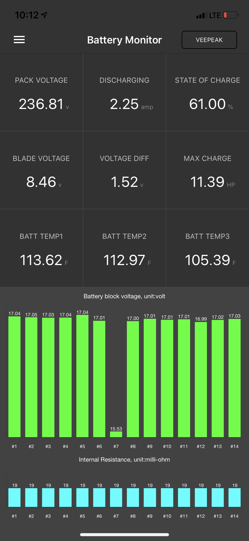

    I purchased this Prius last year and was told the HV battery was replaced with a Dorman several years back. Was performing very well until I got the P0A08 a few days ago.
    I I ordered the Veepeak bluetooth reader for my IOS and Dr Prius app and have the results below.
    The first is after trying to run the full battery test where it was telling me to accelerate hard and break hard. The test was unsuccessful because I didn't realize that the hard acceleration needed to go over 45mph.
    Definitely looks like module #7 will need replacing. The internal resistance numbers look alarming but I think that is due in part to the very hard accelerations during the testing. You can see the battery tems are very high as well.
    The second picture is a few hours later at a more leisurely drive and parked.
    I will be replacing the module #7 without any discharge/charge conditioning as I don't have the necessary tools. I will make sure the voltage of the new module will match the ones in the pack. Hopefully, this get me a few months of trouble free driving. I have 2 modules on order from eBay from a seller that looks to have sold a lot of Prius modules with good feedback and a 6 month warranty.

    You recognize this is a temporary option. I don't understand why your would throw more money away on buying all this equipment to recondition a crappy pack.
    The pack may be under warranty, so before you open it up, contact Dorman.
    If it's not under warranty, clear the codes, order a new battery, and swap it out when you have the chance. You should have a few weeks to months of driving with the failed battery as long as you know it has failed and drive it properly for those conditions. Try not to use the battery especially when not in Stage-4. Reverse into all parking spots so that you aren't using the battery right at the beginning of your drive by reversing out. Mash the pedal to get the engine to spin up and then gradually accelerate, mashing as needed to kick the engine back on. Don't drive on the battery alone. Running the heater helps as that will force the engine on. Roll the windows down, turn on the heater. Don't use the AC. That type of thing.
