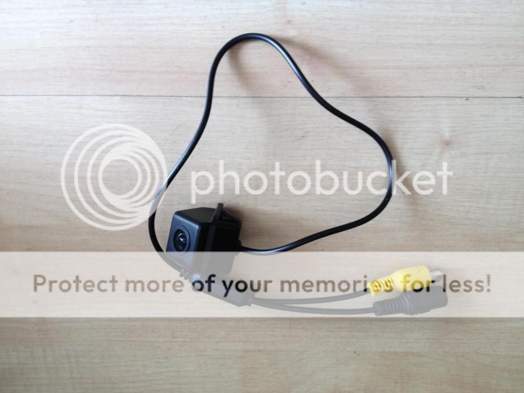

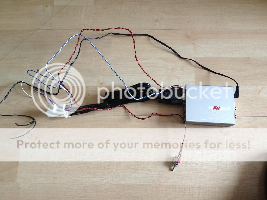

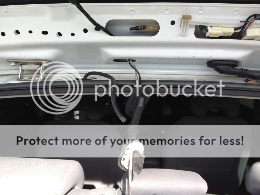

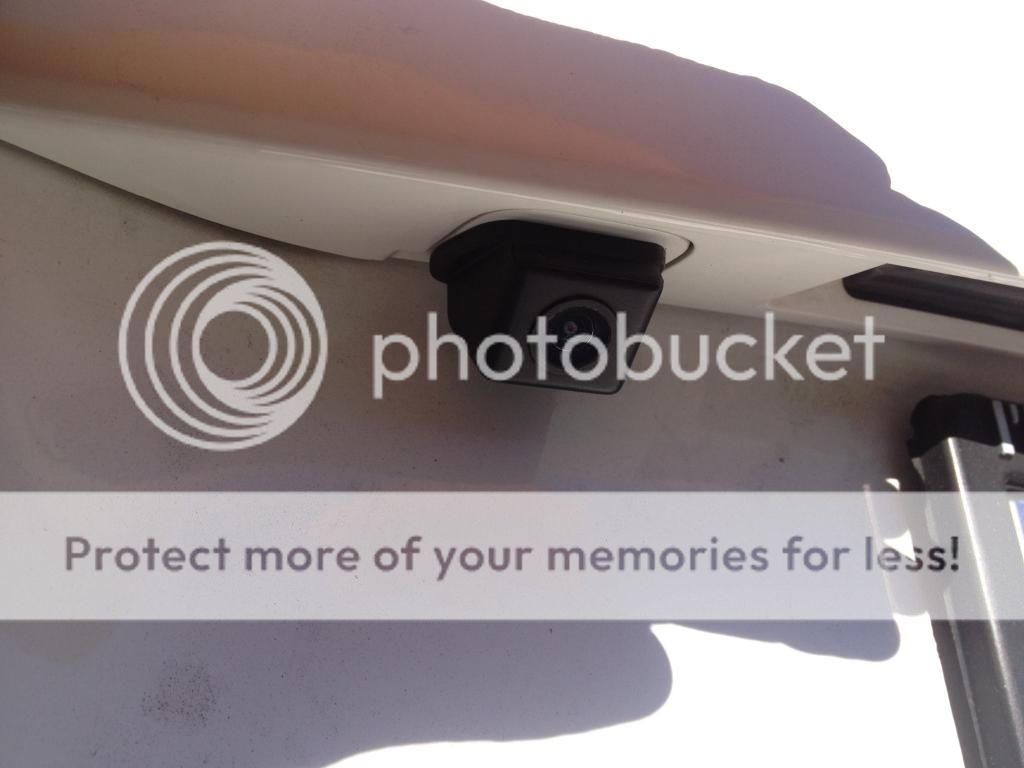

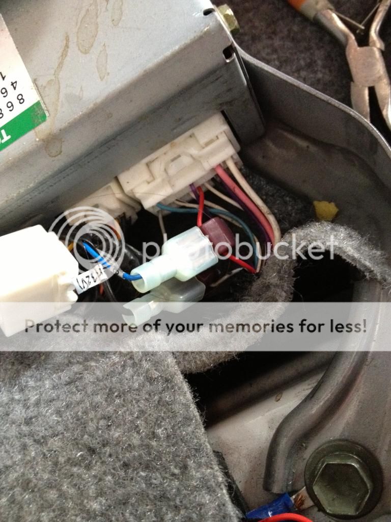

    Hi guys, I just installed a perfectly working factory looking backup camera on my 05 prius. I purchased the Naviks for $179 on sale and the Sony Camera for $19.50. Also have the option to run an external video source to watch movies on the screen. My car came equipped with factory JBL, Bluetooth, and Navigation, so I'm not sure if it will work with other vehicles with lesser options so please don't ask. Links below is what I bought. It only took me about 2 hours to install, but I do have car audio experience. It was fairly easy no wires to cut, just splice into. I ran the cables through the washer hose side, and pulled the hose back through by inserting a screwdriver into the hose and guiding it back through. The video ran across the top driver side down the drivers door, and under the seat. Power source for camera was left rear reverse light in which a relay was needed for a cleaner power source due to the camera having an issue with the power there. I pulled the power from the battery in the back right, and placed a 1amp fuse to a relay. The power for the Naviks was pulled right off the Navigation unit under the seat. For audio you can use the GTA car kit for $99 free ship, and use it with your iphone. Total cost all in all was $300 not including what someone would charge you to install it. This is an awesome feature to have, and makes the vehicle just like the newer models, and places value on it as well. Good Luck!
    Toyota Prius 2001 2005 Nav TV Navigation Video Interface | eBay
    Sony CCD Chip Rear View Reverse Backup Camera for Toyota Camry Prius Aurion | eBay
