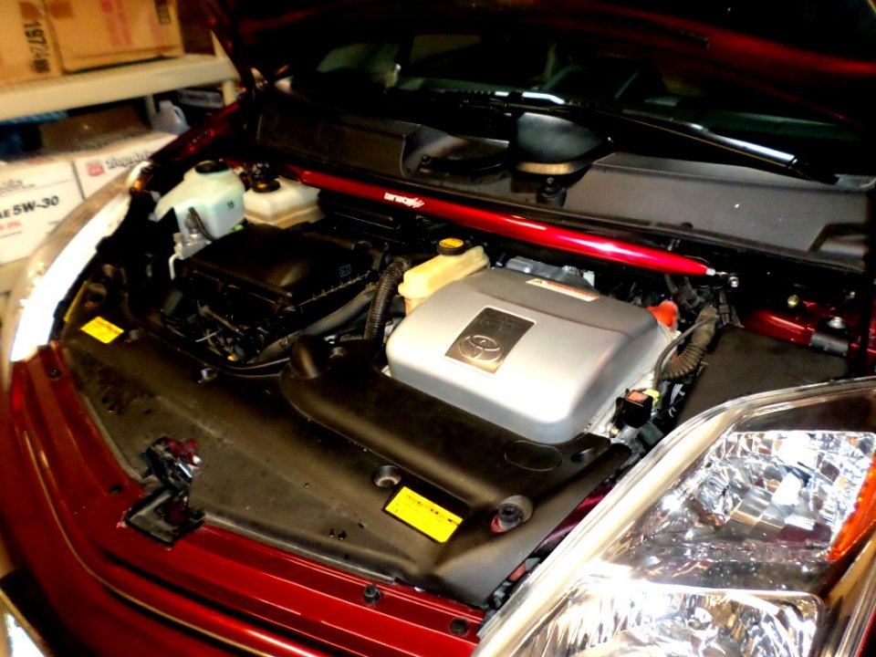

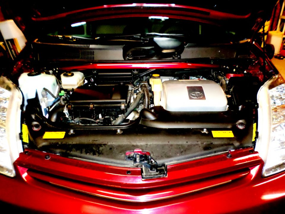

  9. Dino3721
    Dino3721 Junior Member
    Feb 9, 2014
    Omaha NE
    Just got Front strut bar and new front struts. Springs were $150 from Dealer so I got them as well.
    Front Strut bar was: Tanabe TTB151F Sustec Front Tower Bar ($100)
    It rides so nice and smooth! Very happy.
