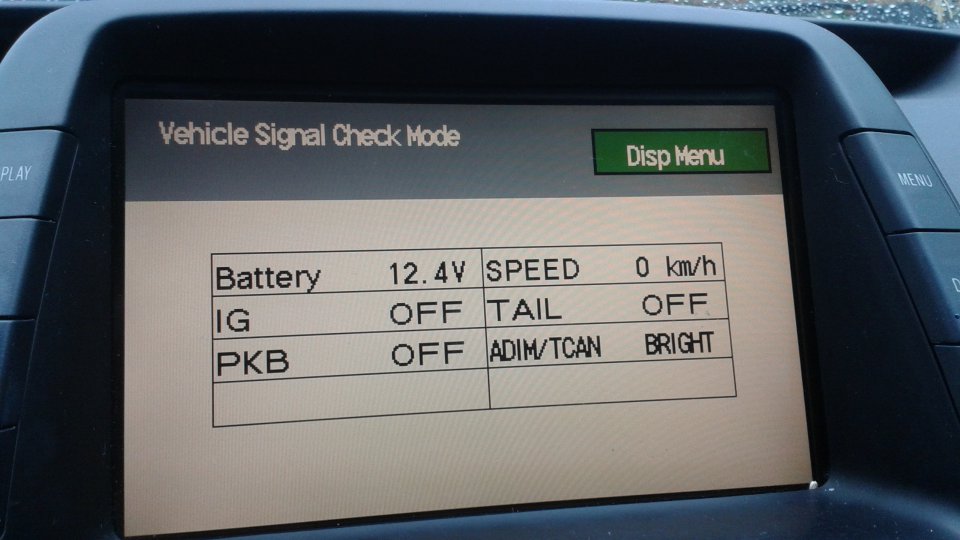

  14. C Jakel
    C Jakel Junior Member
    Jun 19, 2014
    Lockhart, TX
    Here is a pic of signal check in diagnostic mode....12.4 on battery...I did it again later after running headlight s for a little bit and showed 12.3...should I still trickle charge our just let it be

  16. valde3
    valde3 Senior Member
    Jun 28, 2014
    2,002
    751
    Finland
    It’s charged enough. You can test your 12V battery condition more by pressing power again to get to ign-on and putting headlights and rear defroster on and checking the voltage then. If it’s more than 11v its good and if it’s less than 10,3v you definitely need new one.

  19. dolj
    dolj Senior Member
    May 14, 2012
    8,655
    4,406
    Wellington, New Zealand
    No, he didn't. He's talking about AGM and flooded Pb/Acid 12 V batteries. The Schumacher will charge both types.
