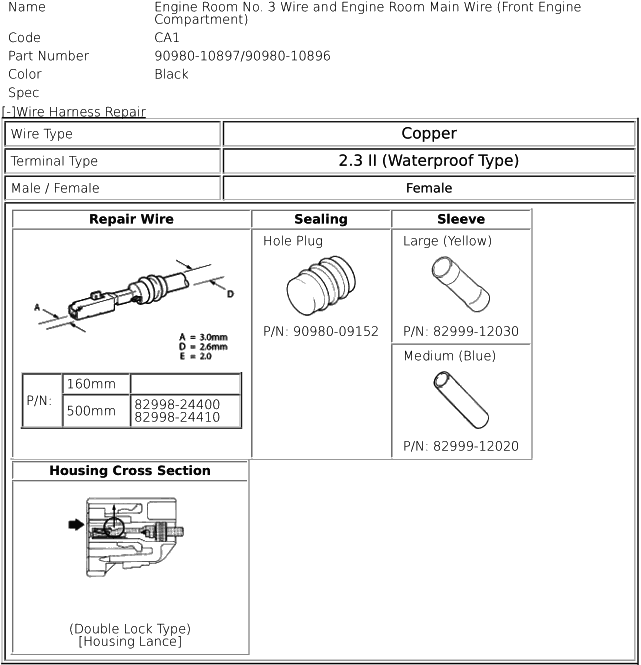

    You can follow along in this post and then this one to see how you get those connector-terminal part numbers out of the wiring diagram. For getting access to that, the wiki page that Elektroingenieur put together has all the details.
    You'll end up somewhere like here, where you'll be able to see the 82998-whatever part numbers for the repair terminals. (Of course this picture is a different example, not the terminals you're looking for.)
