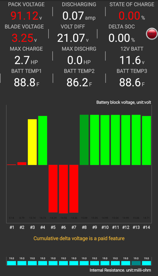

    The car was unresponsive until a 12v jump pack was hooked. I pulled codes P3000 and P3030. I ran Dr. Prius even though I haven't yet read how to use it or if it works with dead batteries. The bars on the left half were fluctuating, some red, some going between red and not red (colorblind). Screenshot attached.
    I understand P3030 could be damaged connections in the battery bus harness (battery monitoring system?) but also this car is 20 years old, how long do these battery packs live?

    You have failure of the voltage sensing wiring or the orange connector on the battery ecu.
    You still might have battery problems besides, but voltage sense is bad.

    The orange plug In your battery connected to battery ECU for the sensor wires oxidized from the fact that the car was parked for a long time and this led to the formation of resistance on several modules and they discharged to zero volts. This usually happens with block 1 and 2. But the screenshot shows that there is also a problem with block 5, 6 and 7. You need to take care of your battery.

    You can't make any assumptions about battery block voltages until the ECU pins and voltage sense wire loom (aka No. 2 Frame Wire) is replaced.
