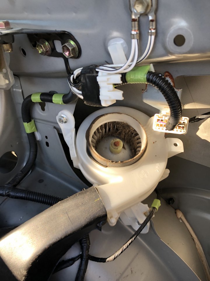

    Given your location and potential for cabin leaks/humidity, you might try checking for corrosion in the HV battery ECU plug / voltage sense harness connector, and again at the white plug near the HV battery fan (right side of the fan in the image below).

    Found some corrosion in the wiring to the right of the HV fan in rear. There was some leakage into the rear of the car when it was parked for those months. Am i gonna need a new HV battery or should i just sell it, someone offered me 4k for it. Can this be as simple as the corrosion i found?
