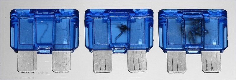

    Remove it and maybe the one above it. Look at them from the side. You will see what looks like a little wire crossing from one side to the other. If that wire, or strip of metal is melted, your fuse is no good. Here's an example:
    The one on the left is (probably) good.
  19. hill
    21,524
    9,038
    Most say yes - they CAN see the blown element
    your vision may vary

  20. dolj
    dolj Senior Member
    May 14, 2012
    8,645
    4,396
    Wellington, New Zealand
    Yes, you are correct and I tripped myself up with having a particular thought in mind. What I should have said to be more clear is: You can't always tell by just looking at it. As the image above shows, the two fuses on the right are clearly blown. But the only way to tell for sure if a fuse is good, is by putting an ohmmeter across it and check for continuity. Just because the first fuse above doesn't look blown, doesn't mean it isn't blown and it was this point I was trying to make. Even Avi, who posted the image, makes this point by saying "The one on the left is (probably) good".
