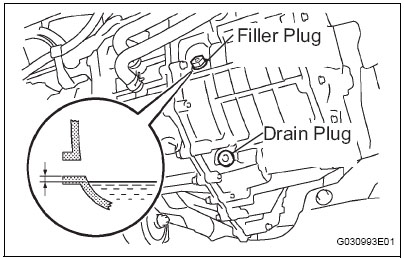

    How do I check the transmission level? If there's any to check. New to prius excuse my ignorance.

    It is important to be to the right of that seam, to the left is coolant plugs.
    Those take a 24 mm Allen socket.

    Hey Jimbo, how often do you check or drain the transmission fluid?

    This is a voodoo topic, as Toyota never mentions ever draining it, so we are left to guess. I do the first drain at 30,000 then every 60,000 miles after that. You are free to make any regular schedule you like.
    As a credit to my dealership, they try to talk me out of it every time. They still believe it is a 'forever' fluid. I respect their honesty in not selling all they can, but make them take my $110 and watch them do the work. (I do not fit under any Prius)
