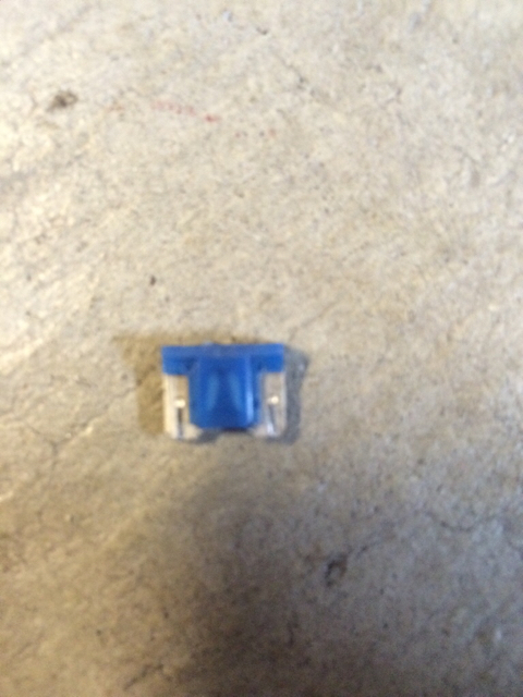

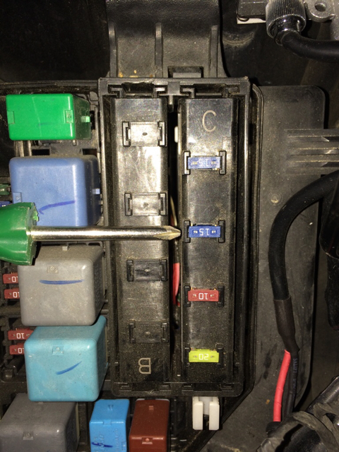

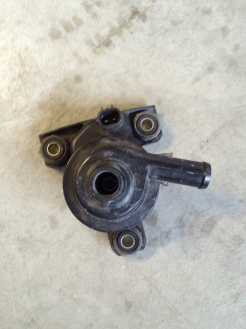

    Thank you to all who sent in tips. Just wanted to share the solution to my problem. The problem was this pump.
    After replacing the pump and bleeding the coolant lines I also replaced the 15amp fuse.
    Happy to report car is running and ready to go.

    There was / is a ongoing recall on the inverter pump. Had it ever been changed before? You can get a refund on parts and they will rein spect .

    Apologies got to admit I missed that one. The pump fails in two basic modes.
    (1) The pump fails to turn because it goes open circuit or seizes. This causes the inverter to shut down through overheating. Turning the car off, and allowing it to cool allows it to be driven again "till it overheats again".
    (2) The pump motor goes short circuit, and blows the fuse with the results you now know. This is not so common as the first scenario.
    The fault has been traced by Toyota to scratched motor winding's in production "the reason for the recall". It would be worth a phone call to Toyota Corporate to see if they are willing to contribute towards the cost of the repairs particularly if you car has low miles. Given the correct attitude in the call they are known to be sympathetic.
    I believe these pumps have been the subject of two recalls. The first for bearing failure, and the pump was replaced with a modified version. The second due to possible scratched winding's in production. This was considered a safety hazard because of the possibility of cars shutting down in the middle of the freeway.

    It would appear Toyota slipped up more with the supply electrics to the pump than the pump it's self. Why was it not on it's own fuse so that a short within the pump would not immediately shut down the car. Monitor the pump current through the ECU? No current, no pump = warning light or DTC light. The car could then be driven in the same way as it is when the pump fails in other modes, but even this should have a warning/DTC light.
    A small modification using a relay fed from the pump supply switching on the pump fed via a separate fuse would be easy to accomplish.
