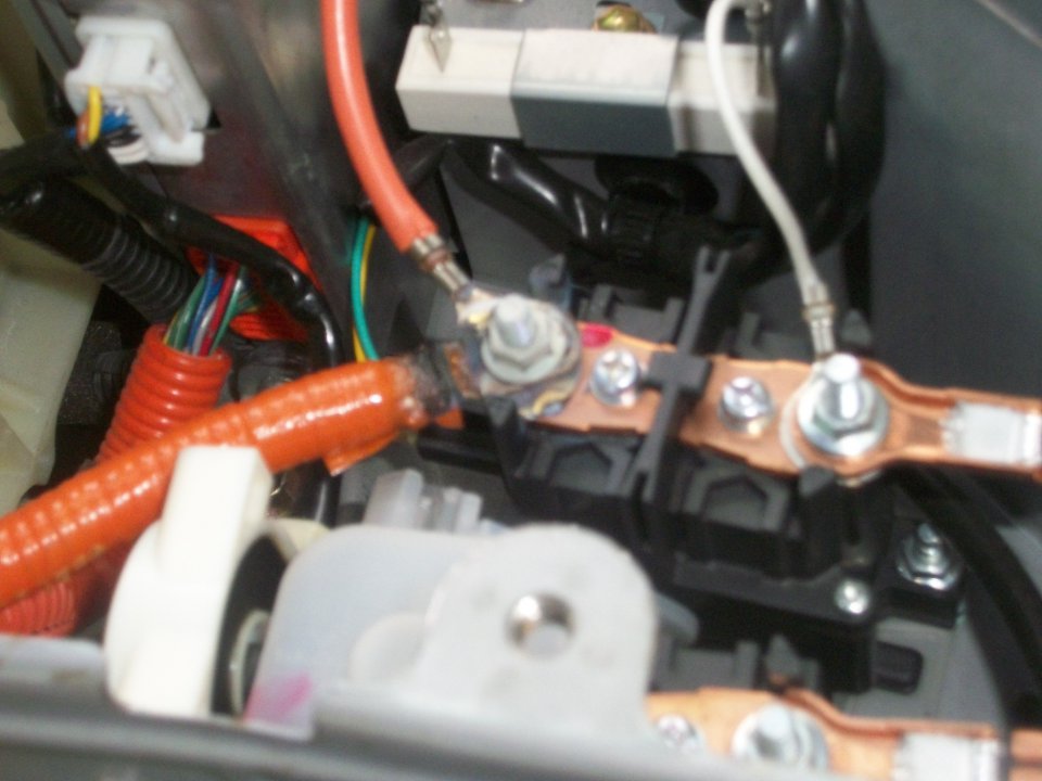

    Prius back up and running.loose connection on sr1 factory side replace from old core called dorman back told not to ship new battery the are great with any issuses. Pic attached thanks to all who try to help .problem fix.pic attached battery pic1-2.JPG battery pic1.JPG

    looks good!(y)

    The pic are before repair
