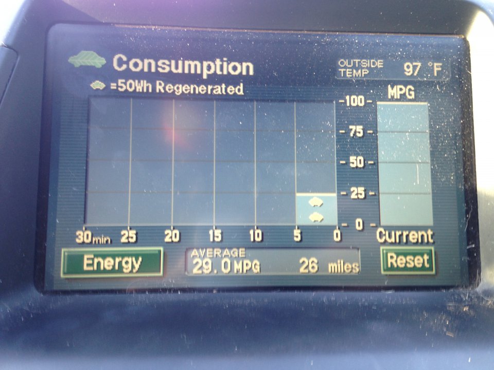

    Yes. I don't feel my mileage should be this bad, unless it is a serious accumulation of issues.
    - What fuel economy are you getting and how are you determining fuel economy? (trip computer or manual calculations)
    trip computer. See attached screen shot

  2. fuzzy1
    17,937
    10,720
    These are the items that jump out at me. High outside temperatures make the AC work hard, though you also mention previous no-AC problems.
    Short trips carry a significant penalty for engine warm-up, in both hybrids and traditional cars, because the warm-up fuel gets averaged out over just a few miles.
    City traffic with numerous stops carries some cost, and waiting time for traffic lights boosts the apparent cost of AC. But city speeds themselves are ideal when done with little or no stopping.
    Hard braking defeats the regenerative braking by sending most of the potential energy into the brake pads instead of the battery.
    But I'm no so sure these are enough to account for the low mpg. Can you test with a longer trip at highway speed? Ideal would be to reset the MPG readout after warming up the engine. This is easy with GenIII models and their trip gauges, but is different on 2005 model. For GenIIs, you might need to warm the engine, then go fill up the gas tank to reset that display.

  3. HDuncan
    HDuncan Member
    Jan 19, 2009
    122
    30
    In the attached photo, couldn't I just hit the reset button after warming up for 5 minutes? I don't understand what filling up does to the trip meter.
  4. fuzzy1
    17,937
    10,720
    If your MPG display works on the trip meter that way, instead of being reset only by refilling the tank, then yes. I don't have a GenII, just know that its MPG displays work different than my newer vintage.
    BTW, for other testing, I meant to say highway speed, not high speed.
    HDuncan likes this.
  5. HDuncan
    HDuncan Member
    Jan 19, 2009
    122
    30
    Hmm I guess I've always assumed that the MPGs only refer to the miles driven after hitting reset.
    When I hit reset, the MPG goes to zero, which makes me feel that the reset button resets both the total miles as well as the MPG.
    Could be wrong but I'll try it anyway and report back!

  7. tanglefoot
    tanglefoot Whee!
    Mar 27, 2007
    625
    188
    Colorado
    I think the short length of trip is the largest factor. If the trip doesn't take much longer than 5 minutes, 25 mpg is pretty typical for the first 5 minutes of driving. It takes about 10 minutes of driving for the 5-min segment to get into the 40s or so. After about 15 minutes of driving, the system is usually in its later warm-up stages, for optimal mpg. The best averages are possible with trips of at least 30 minutes each way.
    I learned (from the forum) that the behavior of the mpg average reset is different in the early 2nd gen and late 2nd gen. On earlier cars, the mpg average resets at fuel fill-up. On later cars (I believe 2006-2009), the mpg average does not reset at fuel fill-up. On all cars, the "reset" button should reset both the mpg average and mile counter on the MFD.
    #7 tanglefoot, Jun 11, 2014

  9. fuzzy1
    17,937
    10,720
    I may be confusing this with the automatic tank MPG feature on GenIIs, or maybe just some of them as suggested by Tanglefoot. GenIII models lack this automatic measurement, annoying numerous former GenII owners.
