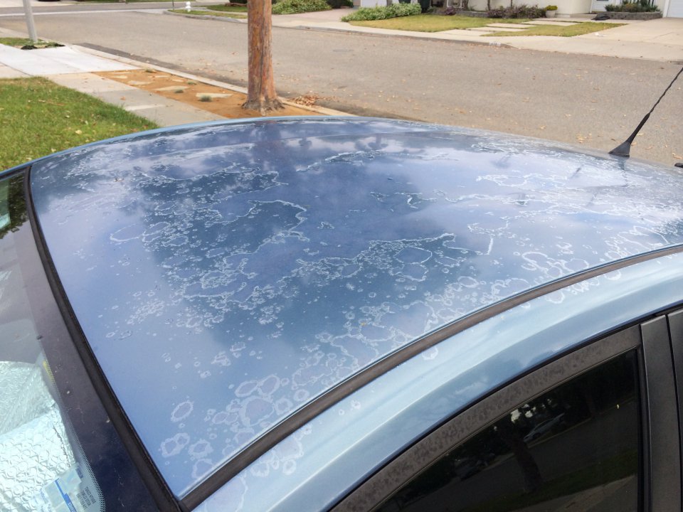

    For the past several months, I've been losing the clear coat (I believe) from the fro of of my Prius. It started small and kept spreading. Now most of the roof is gone and it's starting down the edges of the doors.
    Clear plastic continues to flake off and it appears that where it has the paint itself is fading.
    My Prius is parked outside in sunny California, so it's definitely been in a lot of sun, but I've taken good care of it. Has anyone else had a similar problem? Any fixes that don't involve a complete new paint job?

    are you the first owner? For an 8 year old car to look like that, it would have to have been repainted with a cheap clearcoat or you have it in the sun and rarely wash it.

    The dirt on the car eats away at the paint. In really hot weather (maybe you are in the hotter parts of CA), this will accelerate the paint destruction.

    Honda used to have a problem with their dark blue paint on their Odyssey vans. They offered an extended warranty on the car and repainted most of them for the owners. Some paints/clear coats are just more problematic.
    Lucky for us, the blue paint on the Prius isn't that expensive to repaint....compared to a red Prius.

    I would think only the roof, hood, and trunk area is like this. You can probably get only those areas painted at a reasonable price. No need to paint the sides of the car.

    I took it to a couple different paint shops and they both essentially said the same thing: it's not worth it. They pointed out how the peeling was starting at the top of the doors and that you'd really have to repaint the whole thing and to do a really good job would be more than it's worth.
    Since then, the clear coat on the roof is gone and the hood has some large bubbles on it already. Quite a bummer for such a great car.

    To do it right the old paint has to be stripped off. If it isn't it will continue to delaminate under the new paint. How much should be spent to restore a car with no collectible value?
    If an inexpensive paint job is going to be done then sell the car before the warranty expires. The new paint will start to blister and peel shortly thereafter.
    Paint isn't as durable as it used to be. The cars that I have seen with paint in that condition come with owners that didn't wash & wax.
