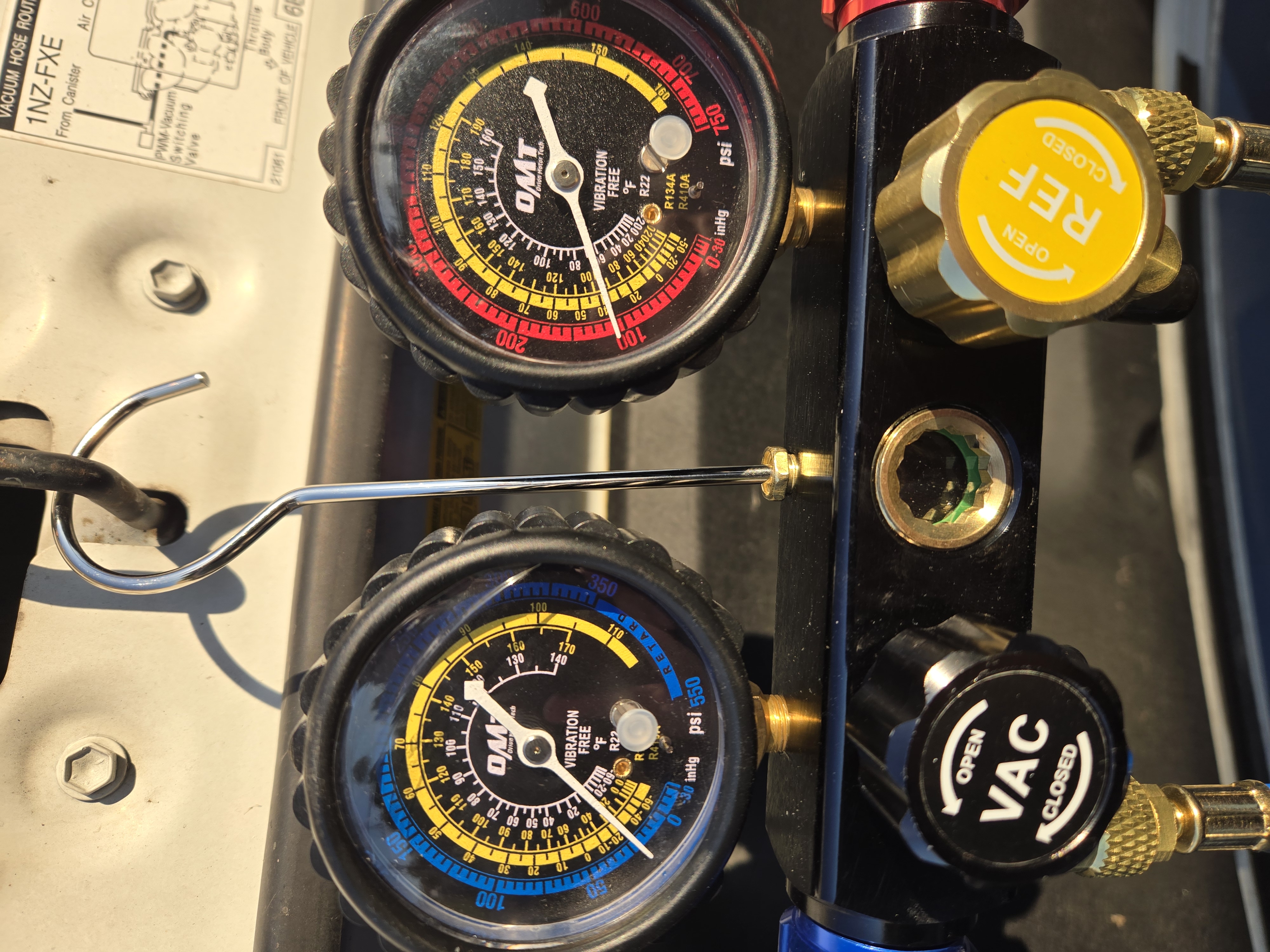

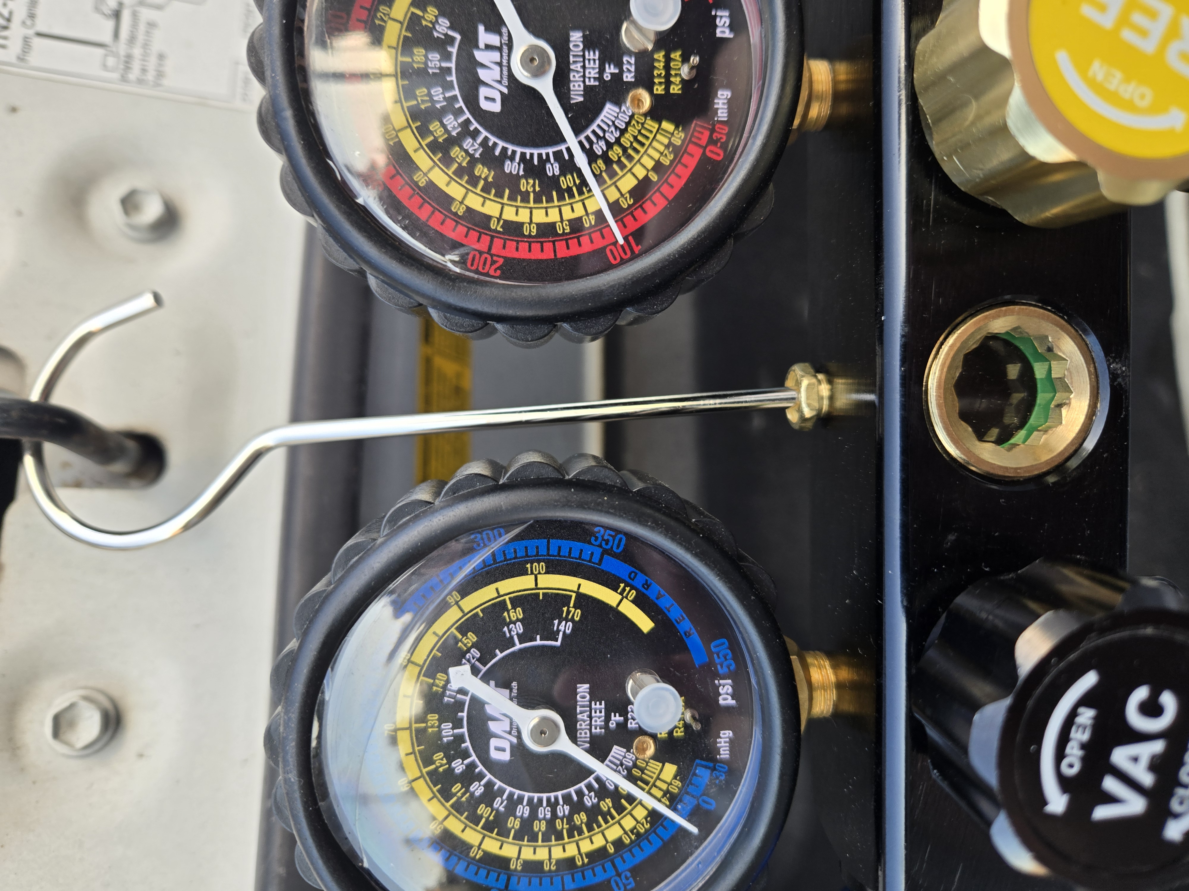

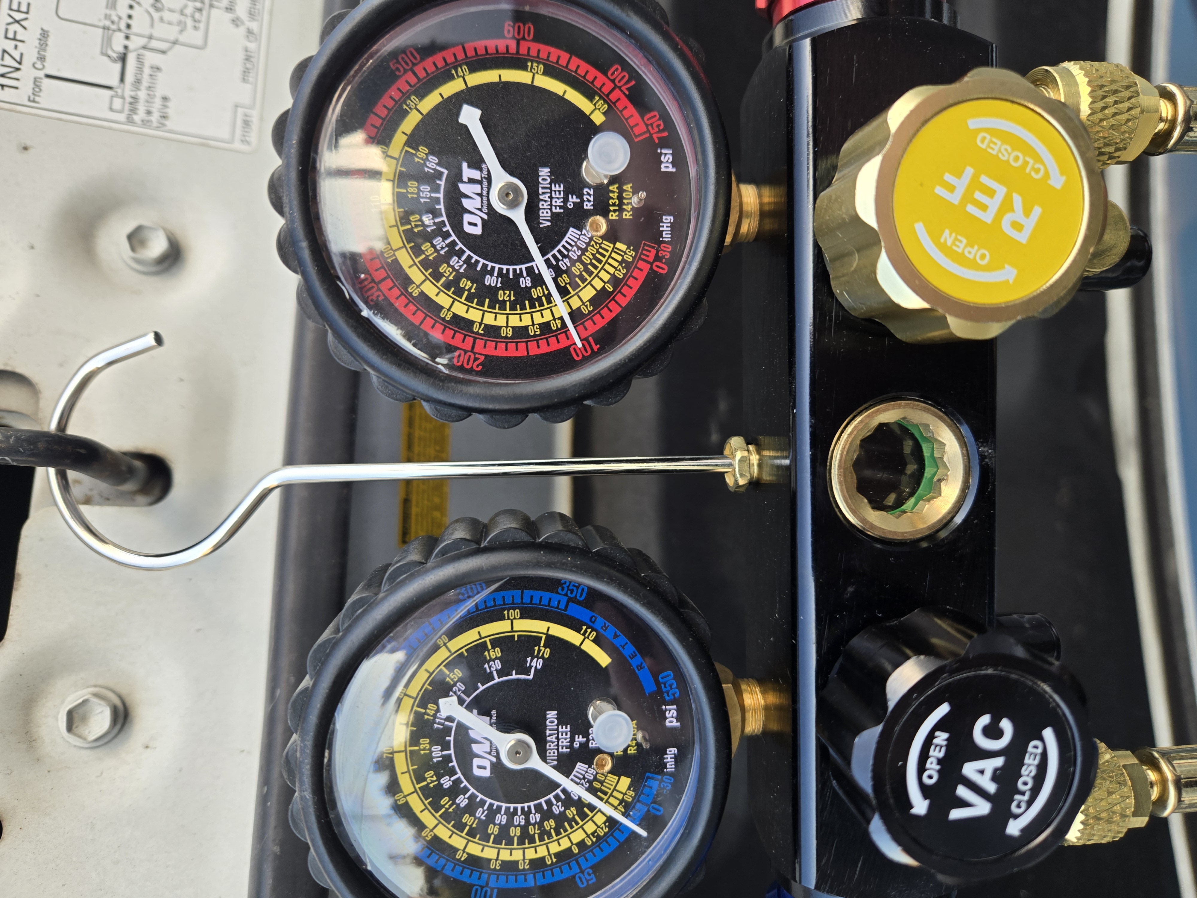

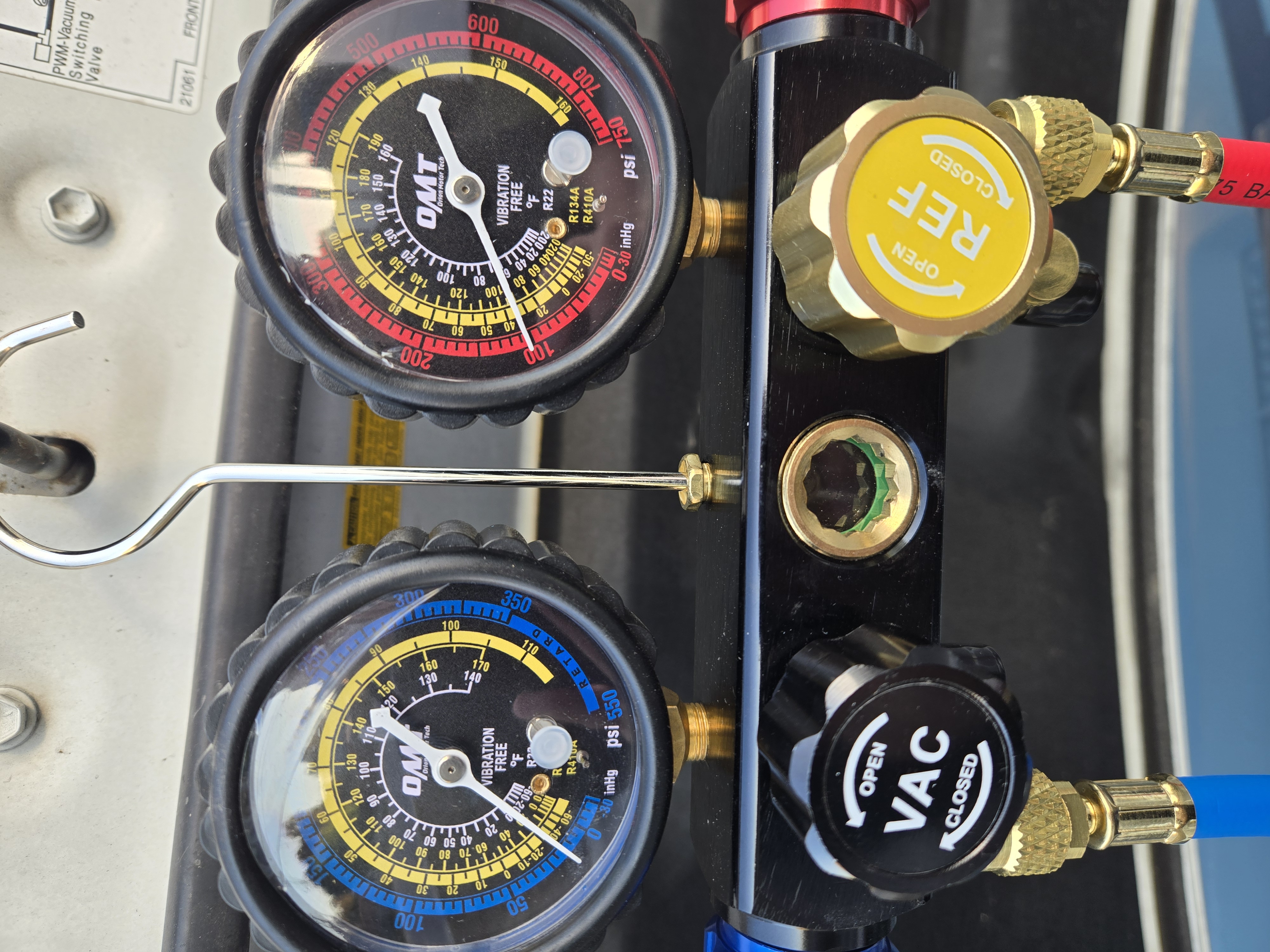

  18. daveyedgar
    daveyedgar Junior Member
    Feb 14, 2019
    21
    Tampa
    I was able to set up gauges on my ac system. Unfortunately I wasn't able to get techstream to work so I don't have those readings. I included screen shots.
    car is off.
    The next 4 are readings taken over a 30 minute period with the temp on low, fan high, ac on. first on fresh air then on circulate.
    this final image is when the car was shut off
    Would like any input thanks.

  20. Tombukt2
    Tombukt2 Senior Member
    Nov 29, 2020
    13,875
    2,521
    Durham NC
    This is the United States right where this car is is gauges are us gauges? You don't have enough gas pressure to be doing much of anything with.
