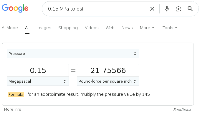

    I have the shop manual and it states:
    The refrigeration system functions normally Gauge reading:
    Low-pressure side: 0.15 to 0.25 MPa (1.5 to 2.5 kgf/cm2)
    High-pressure side: 1.37 to 1.57 MPa (14 to 16 kgf/cm2)
    I tried using an online converter to psi but it didn't make sense.
    I can't find anywhere what the readings should be in psi.

    Conversion is pretty straight forward.
    Low-pressure side: 0.15 to 0.25 MPa (22 to 36 PSI)
    High-pressure side: 1.37 to 1.57 MPa (199 to 228 PSI)

    Thanks for the info. The online converter on google gave me strange conversions. Glad you settled that for me.

  6. ChapmanF
    28,751
    19,056
    Seems to work ok for me; what happened for you?
  7. daveyedgar
    daveyedgar Junior Member
    Feb 14, 2019
    21
    Tampa
    I guess I should have used google
  8. dolj
    dolj Senior Member
    May 14, 2012
    8,655
    4,406
    Wellington, New Zealand
    Or ... chosen MegaPascals, not milliPascals.
    Brian1954 likes this.
  9. ChapmanF
    28,751
    19,056
    Ah. So daveyedgar gave the prompt "mpa to psi converter", all in lower case, and Google honored the difference between m for milli and M for mega. As it should, I'd say.
    But that means it is not ignoring case, so maybe it should kinda warn you about that somehow.
    It would be easy in this example, given that the abbreviation for pascals is Pa, so it could say something like "I saw pa, did you mean Pa for pascals?".
