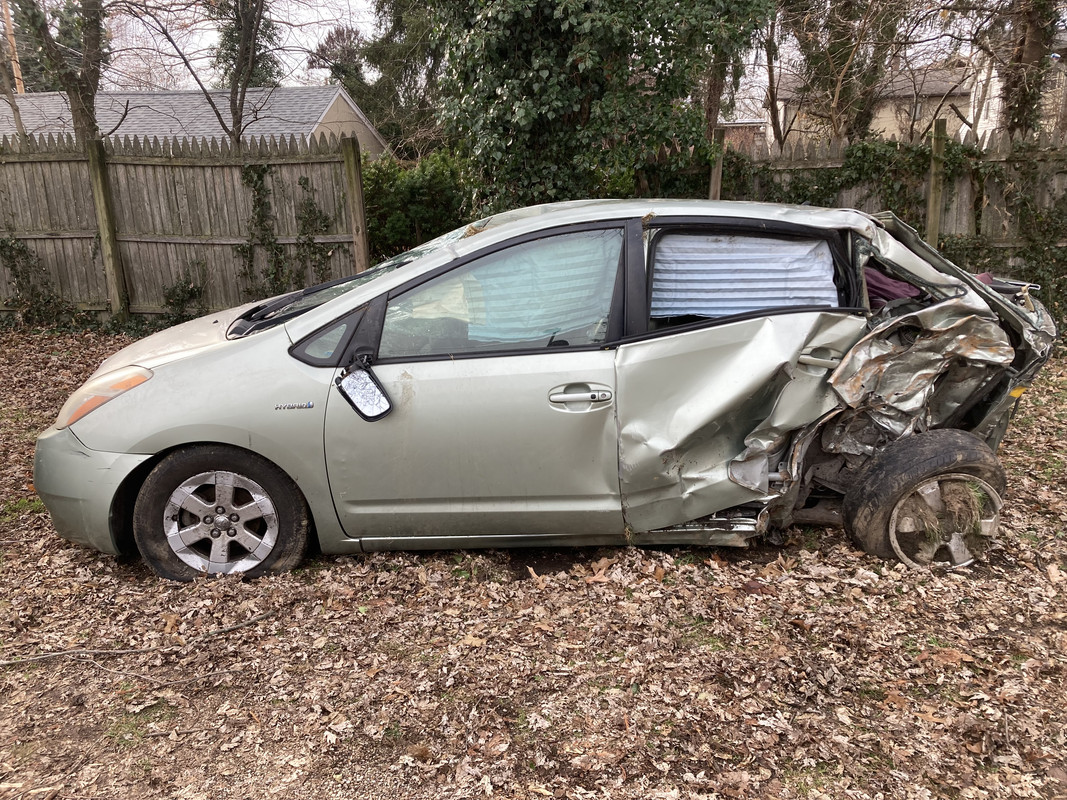

    I have a wrecked 2007 Prius in my yard but have been keeping it for years in case I ever need to grab the engine, brake stuff or whatever. Only the rear end got hit and it flipped over a couple of times but the front is perfecto.
