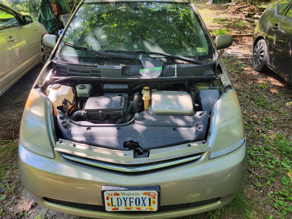

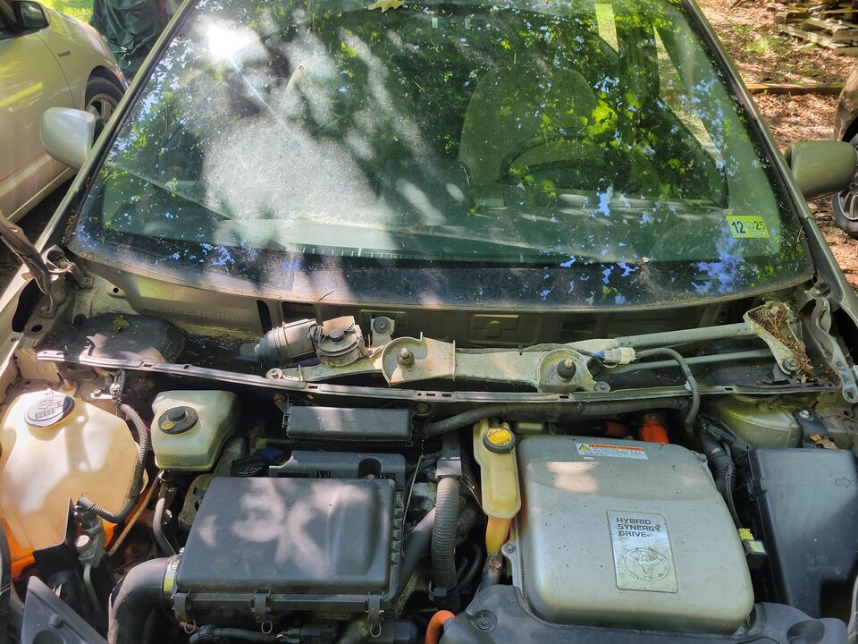

    Starting this as a new thread. This is going to try to be as "Step by Step" as possible. Also so I can look back if I need to.
    Everything "small" is being put in ziplock backs and being labeled with a sharpie.
    Day One:

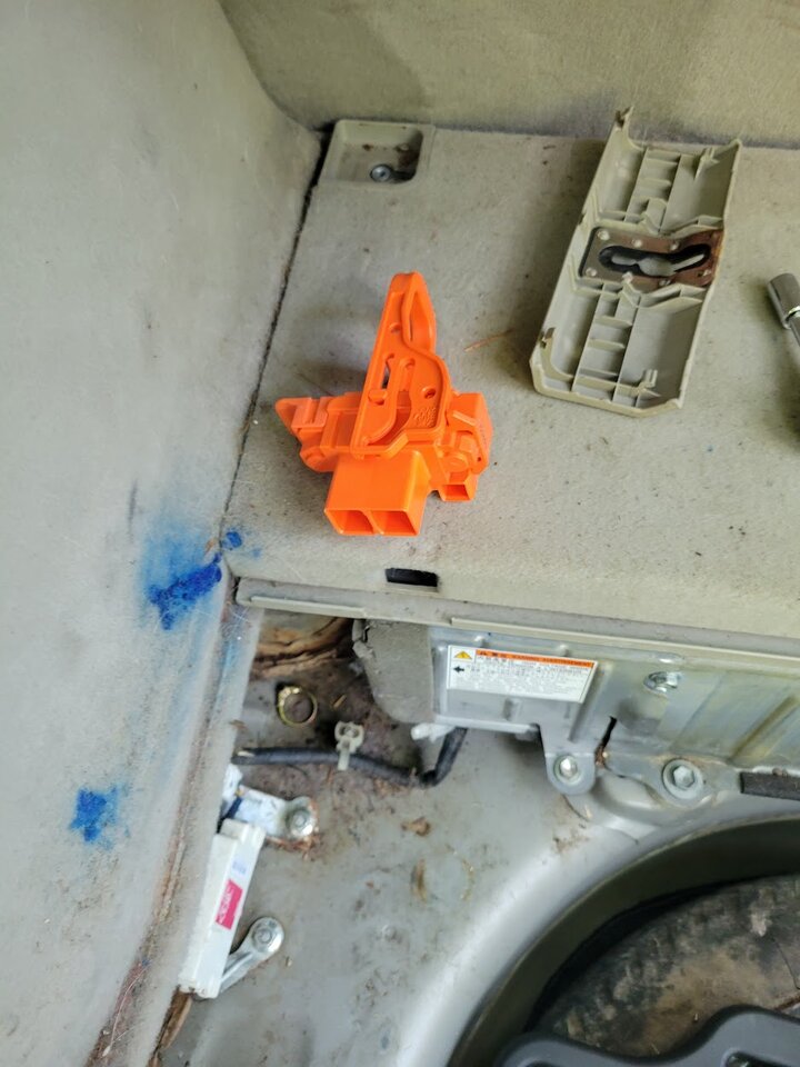

    1. Start with removing battery plug and disconnect the aux battery (10 mm on the wall of the car)

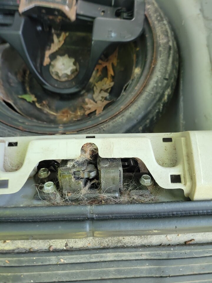

    2. Moved the lock of the hatchback so that it will not lock

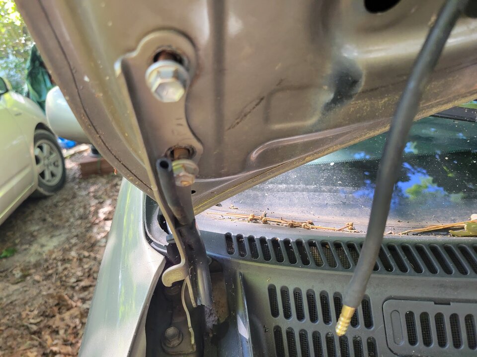

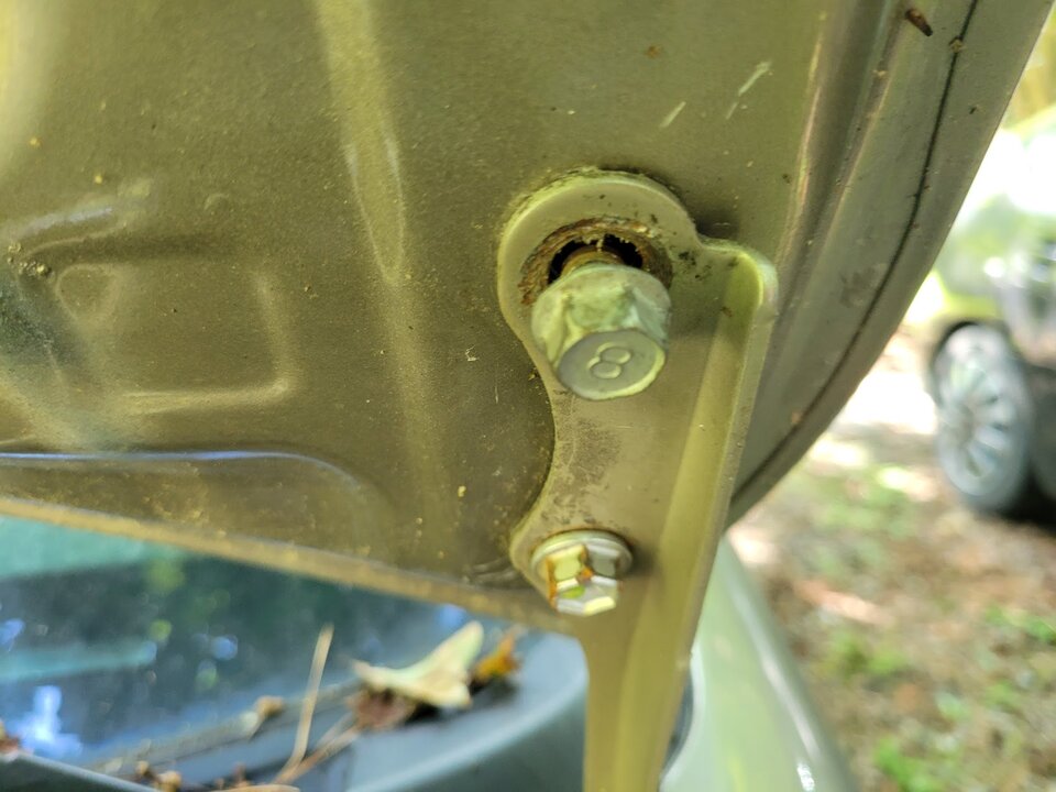

    3. Disconnect bolts holding hood and line for windshield wipers (12 mm)
    Note that when I tried to replace the hood before I put a plumbing fixture in to make it easy to remove
    4. Remove wiper arms (14 mm)
    The double one you need to wiggle around a little to get it off.
    Prying does not really work. Wiggle it

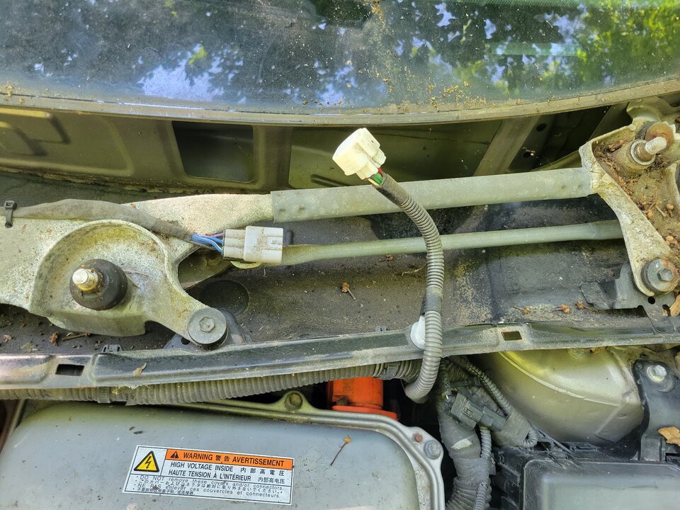

    5. Remove plastic cover on windshield wiper "tray." Came off easy.
    6. Disconnect the wiring harness to the wiper motor assembly and remove bolts holding motor in (10 mm)
    Remove plastic clip from wiper motor "tray"
    Wiper motor should come out easy
    7. Remove bolts holding relay box on tray (10 mm), remove clips holding relay box to tray, and then tray on (10 mm). Should come off easy once bolts are removed.
    Waiting on the electrical system to drain completely so covered engine compartment with plastic so that no water, or at least little water, gets in the engine compartment. Going to try to do just a little a day.

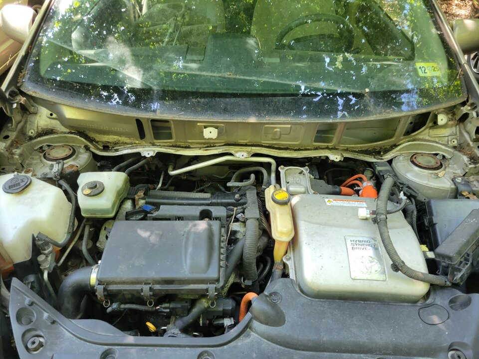

    1. Removed air box. Two 10 mm screws on engine. When I last removed the air box, the hose clamps were not worth trying to reuse so replaced with new ones. If you are reusing the old ones, may need a lot of PB Blaster first. Wire harness holding the MAF sensor. Used a pick to get it loose. Spraying down the bolts / screws to the MAF sensor in hopes of replacing the screws.

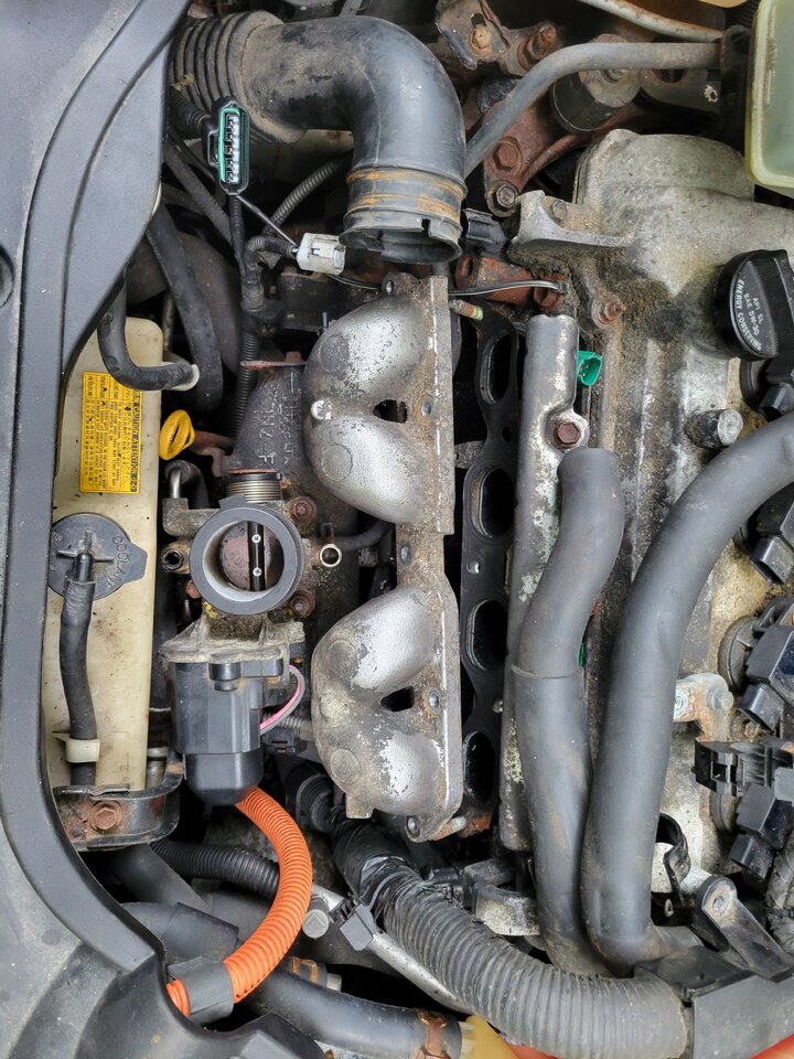

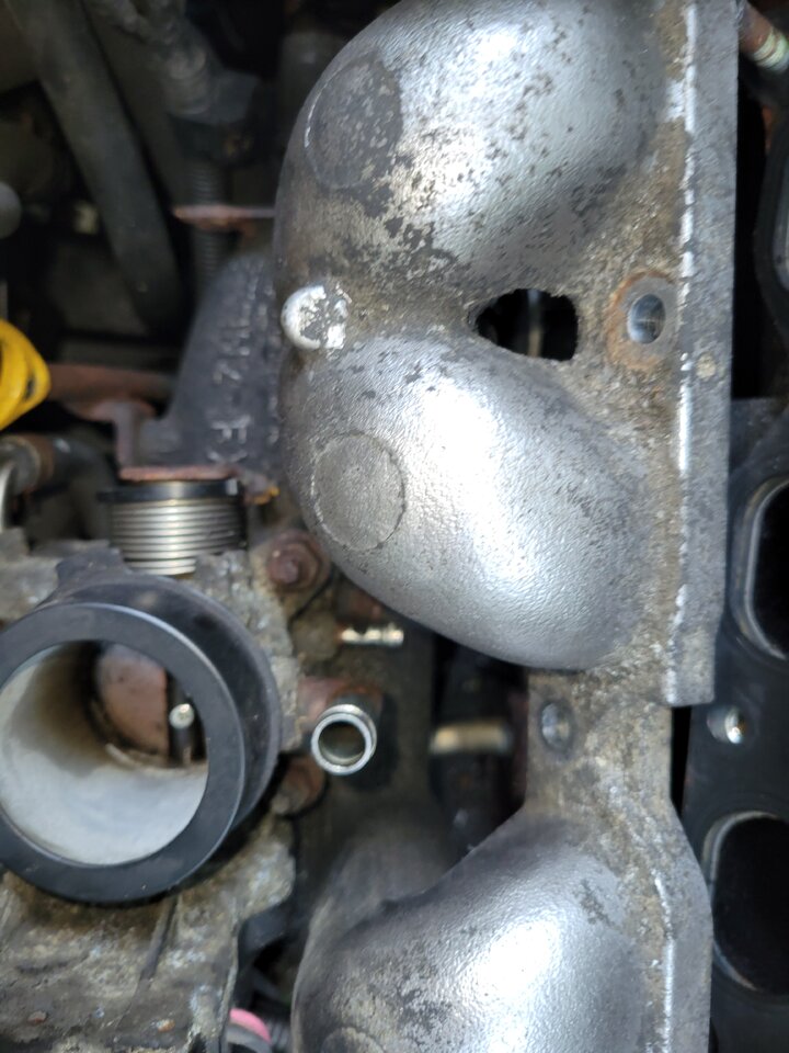

    4. Unbolted, slid out intake manifold

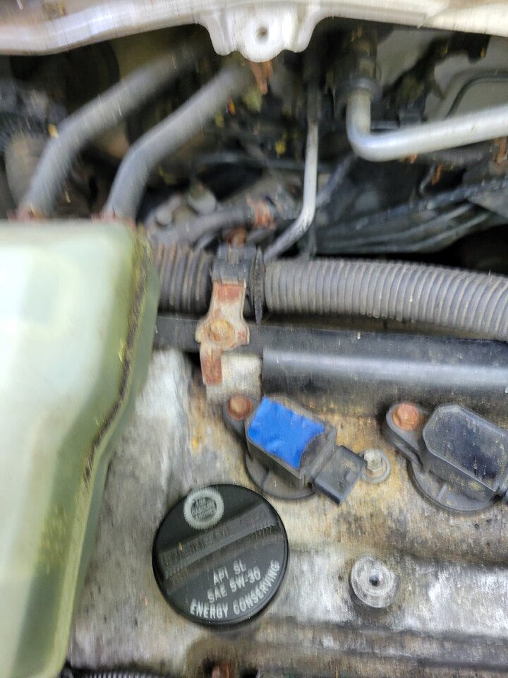

    Five bolts, all 12 mm. Sprayed them down heavily with PB Blaster. The outer ones however will need a deep socket to remove. Of note, the two hoses that go into the manifold just use butterfly type clips. The bolt on the driver's side was crazy to get to and why it took so long. Could have likely just removed the two hoses and gotten to it far easier. Also like 100 degrees outside. Ended up prying a bit with a large screwdriver to get the intake manifold off. Some wires still are attaching the intake but have not removed yet. I removed a clip holding the wire to the driver's side of a bracket on the intake manifold and then that bracket to get to the driver's side of the intake manifold. 10 mm holding bracket and royal pain to get to. What you do that is pry outward on the other side of where the hose / wire bundle is. Removed wire harness on passenger side of manifold. Carefully used need nose pliers to unlock.
    Fourth image is really blurry
    Stopped at that point. Covered engine with plastic and put away my tools.

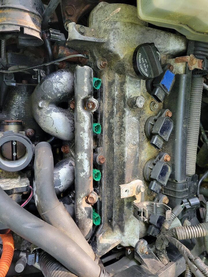

    Day Three:
    Yesterday it was my birthday, so wanted to spent one day not working on things. Did not study either. Studying for a cyber security certificate with planned test day of first week or second week of July.
    Felt that Wednesday I did not do enough pictures, so trying to do better today
    Also saw that the video I have been following completely removed the manifold / throttle body.
    Better picture of the top of the engine with the manifold loose

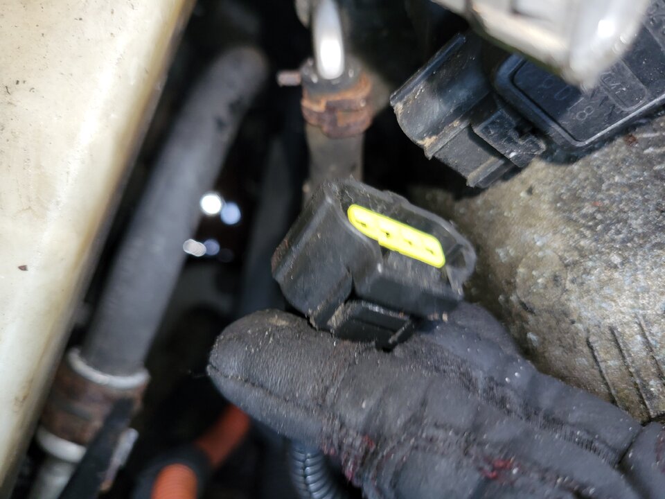

    1. Disconnect this black and red wiring harness connector

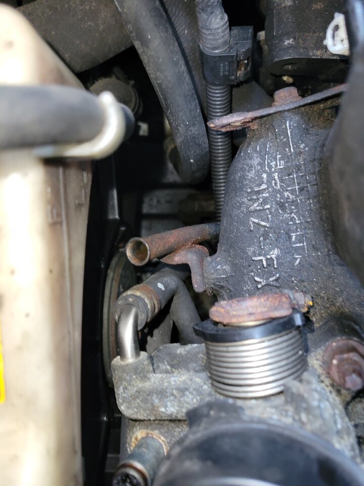

    2. Disconnected lower hose clamp on manifold / throttle body on engine side of throttle body

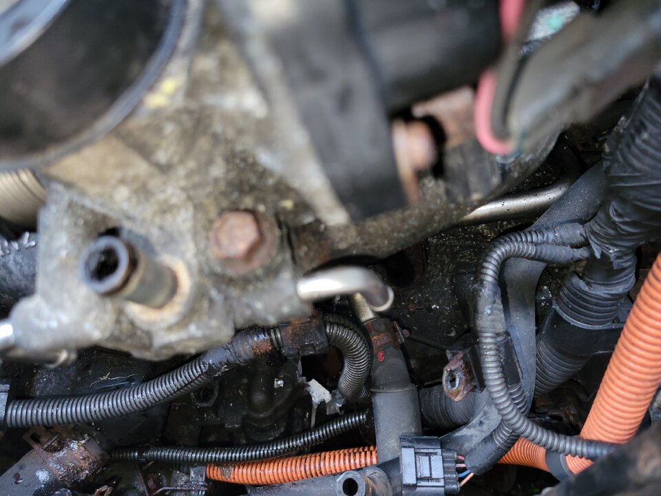

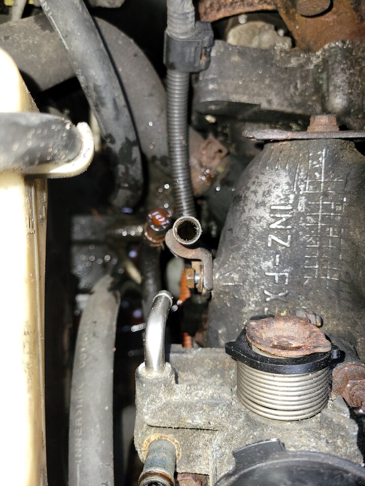

    3. Trying to remove oil dipstick pipe but actually broke off near the pan. Hose in the way but needed to remove the hose anyway.
    Passenger front side of manifold / throttle body
    Ended up mangling it when getting it off so likely try to replace with a screw on hose clamp if I can get it to fit
    Note, started leaking some kind of red looking fluid after removal. Can see it in the picture for #4. Put pan under car to catch it. Does anyone know what the fluid is?

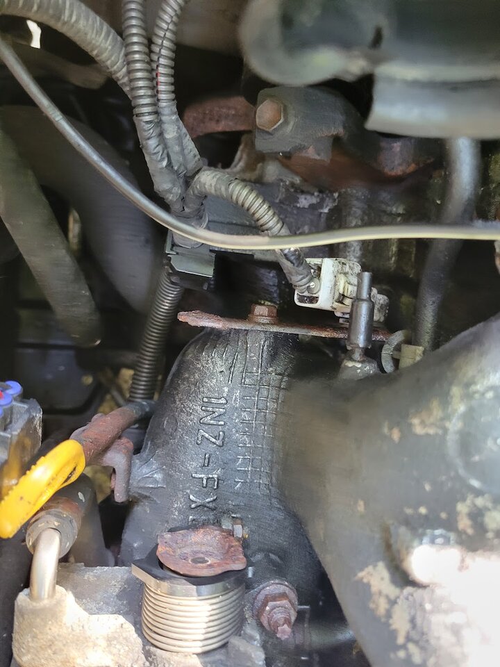

    4. Removed oil dipstick pipe from exhaust manifold / throttle body (10 mm bolt)

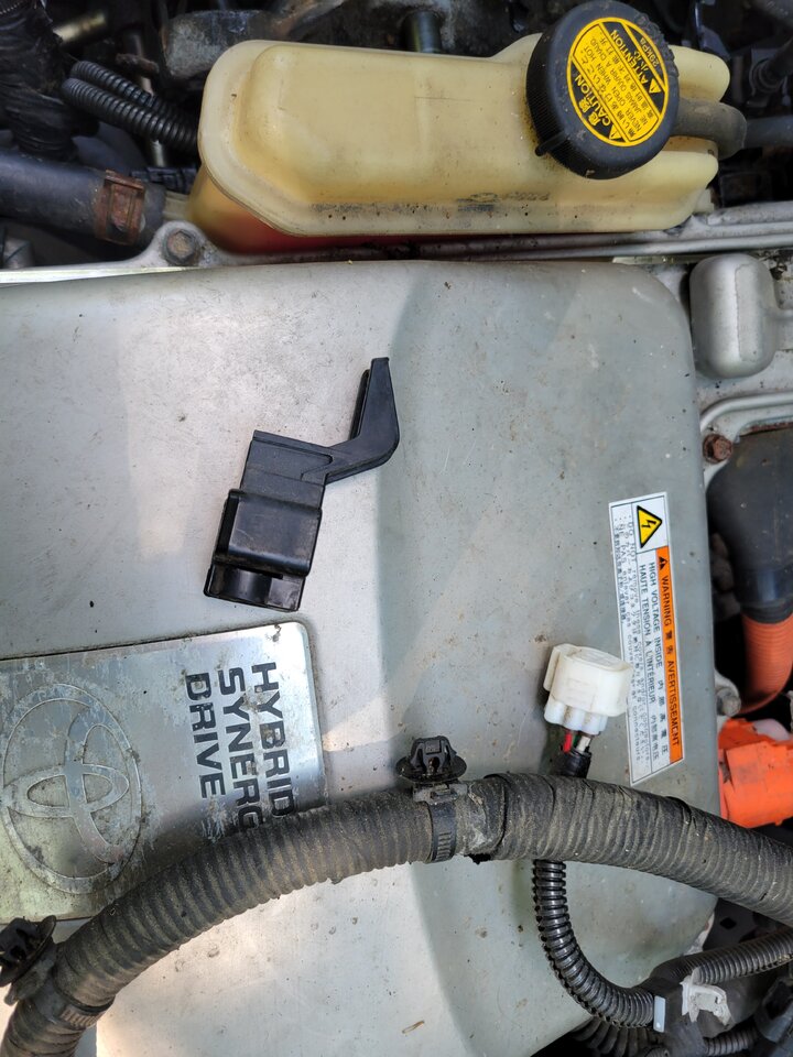

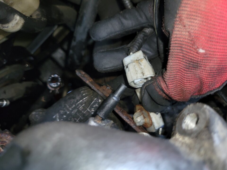

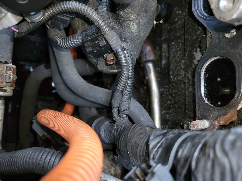

    5. Removed white wire harness connector from driver's side of exhaust manifold / throttle body.

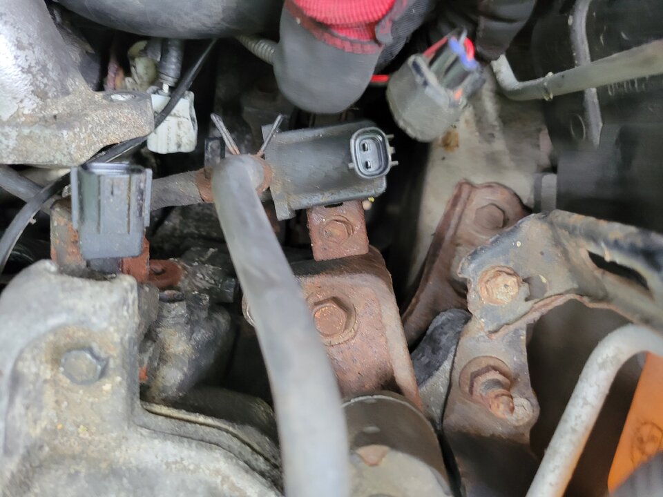

    6. Unbolted wire harness from driver's side of exhaust manifold / throttle body.
    Some one as white connector (10 mm bolt)
    7. Released wire harness that is kind of under exhaust manifold / throttle body.
    Driver's side I believe

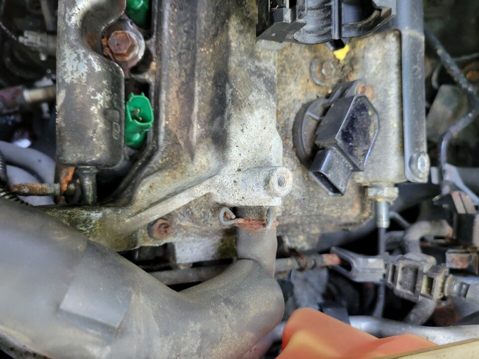

    8. Disconnected hose clamp on driver's side front of manifold / throttle body

    Engine compartment with no manifold / throttle body

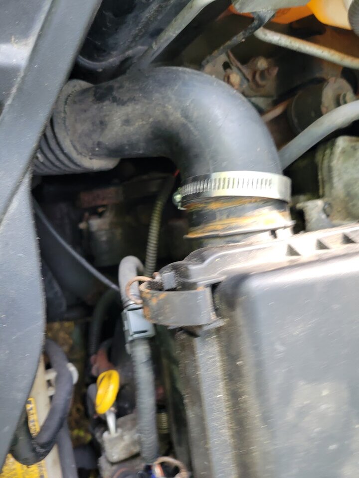

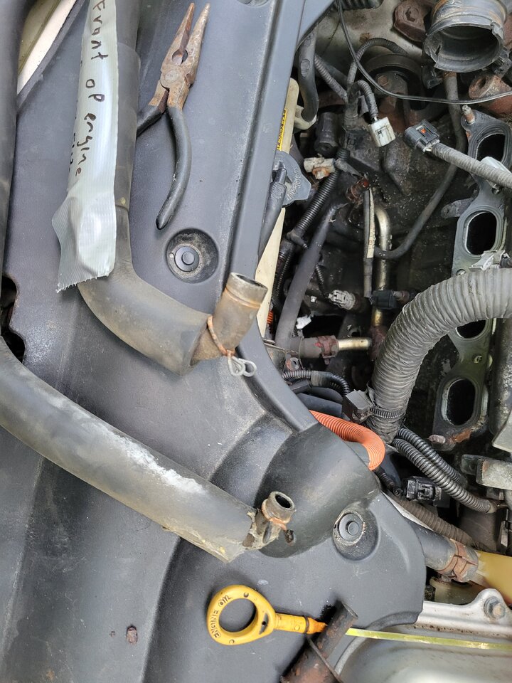

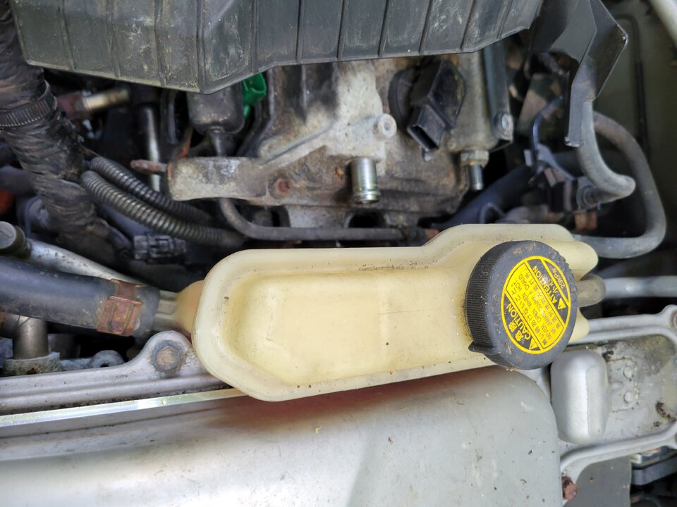

    1. Pushed the plastic shield out of the way. Released Hose that goes to back side of driver's side of engine block that came from the throttle body. Also released the hose that went to the front side of drives side of engine block. Labeled both hoses with tape. 90 degree angle side goes to engine side.
    There is a plastic clip that was loose and while I suspect it held the two hoses together under the plastic but not 100% sure. I guess check carefully for that clip when taking out the second engine.
    Hose Clamp-06.jpg Hose Clamp-07.jpg Hose Clamp-08.jpg Clip-01.jpg Hoses-01.jpg

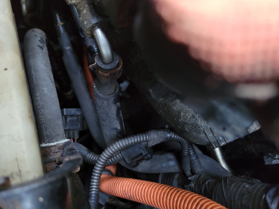

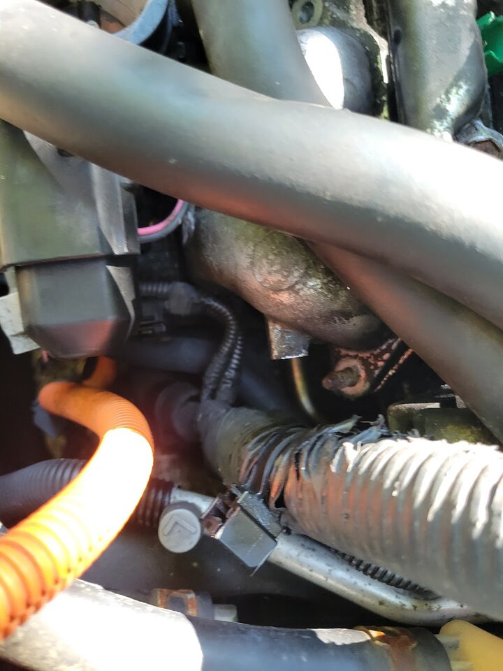

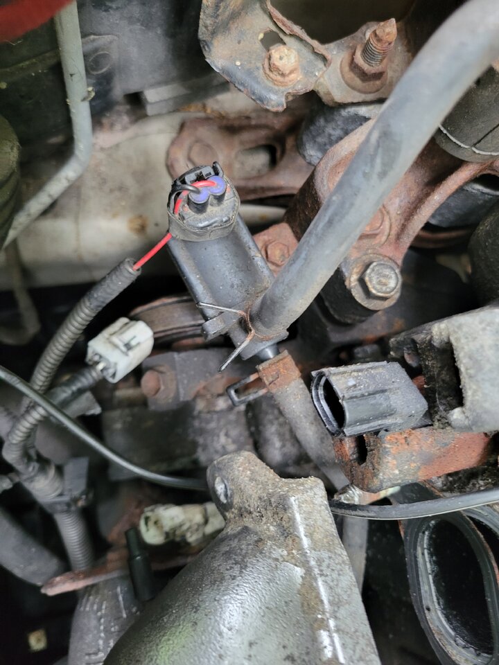

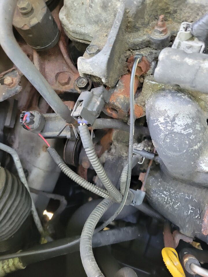

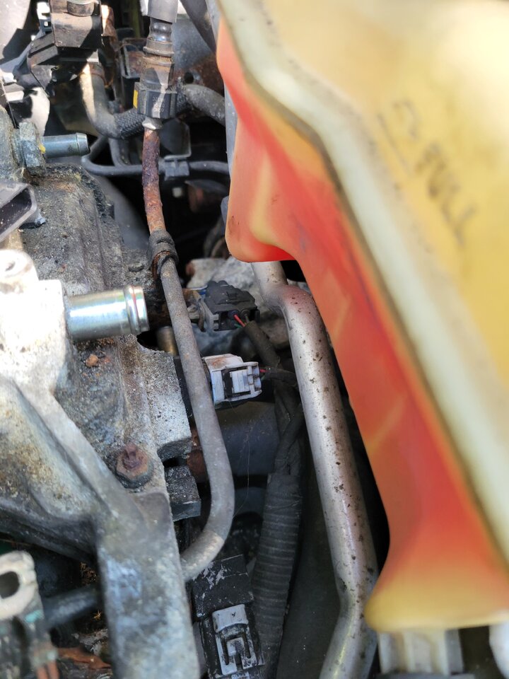

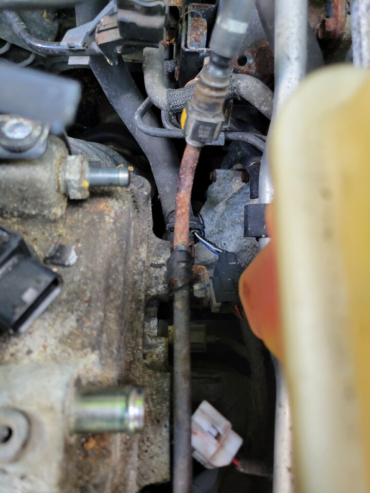

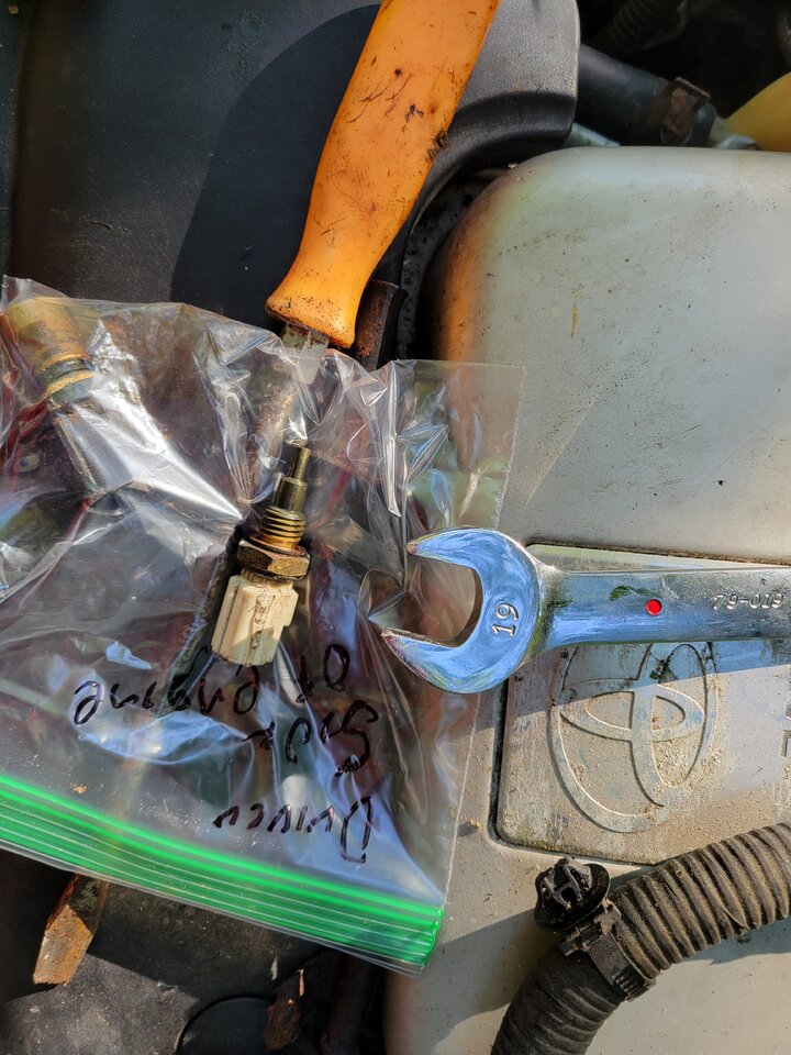

    2. Removed Sensor on driver's side of engine to try to get at hose clamps on that side.

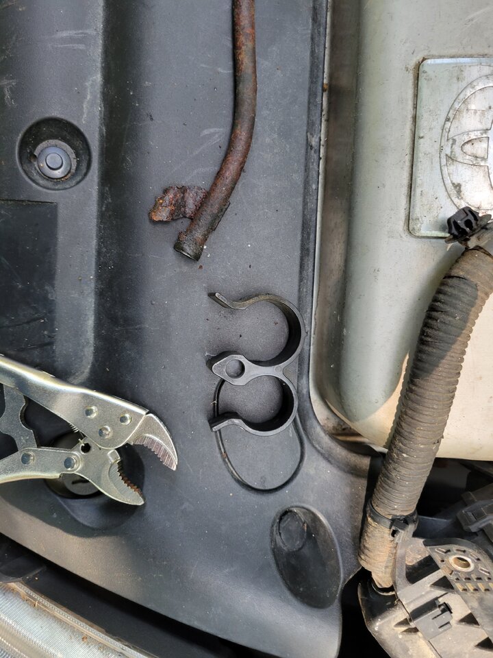

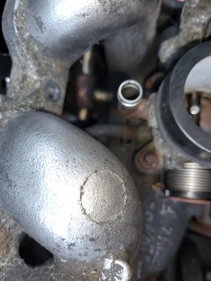

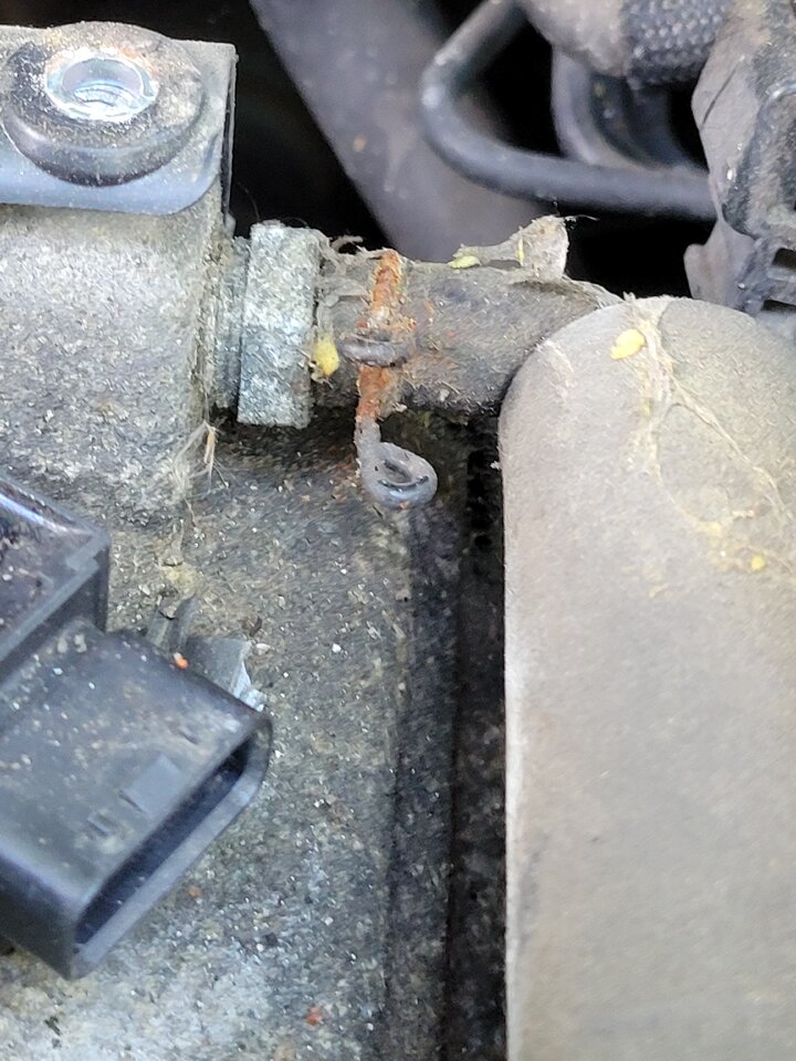

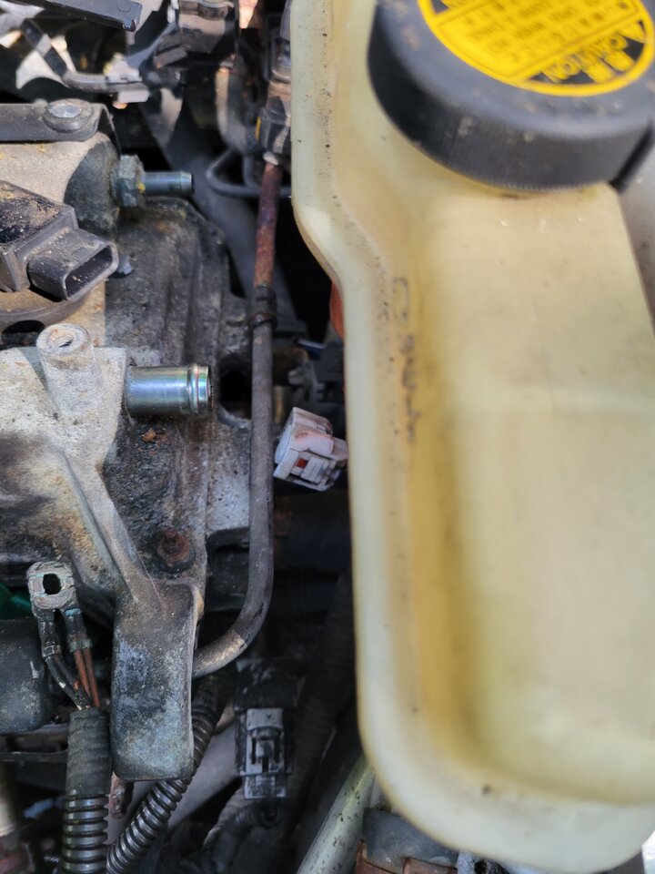

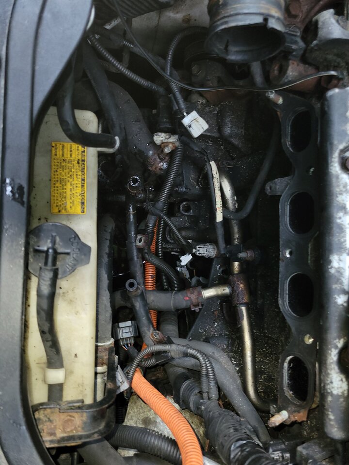

    3. Tired to remove hose on driver's side of engine but hose clamp broke and having trouble removing it

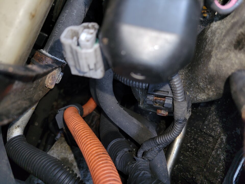

    4. Disconnected Wire harness on front lower area area of engine

    No none of that stuff I'll be an any kind of issue. Usually I'm at the engine connect to chain point in about 1. 5 hrs or so going back is way faster all wires n hoses fall wer they go more or less seriously.
  13. KitsuneVoss
    KitsuneVoss Member
    Nov 13, 2022
    376
    55

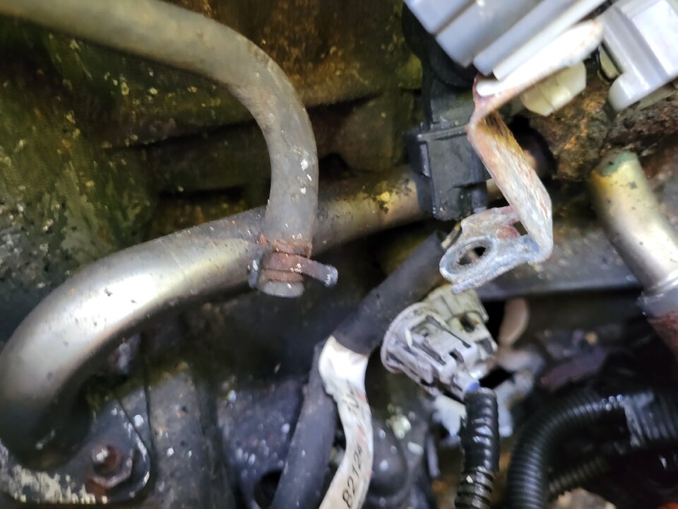

    Virginia
    I don't understand what you mean? Do you just cut the hoses? I am thinking I should replace all hoses anyway.
    I have had two hose clamps now snap instead of opening. They are badly rusted.

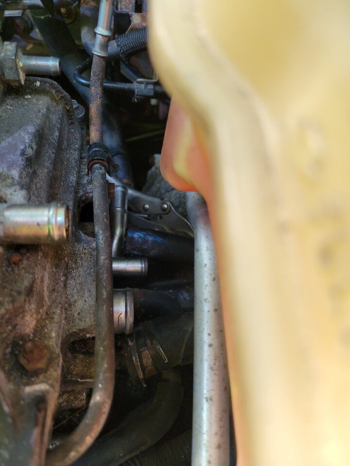

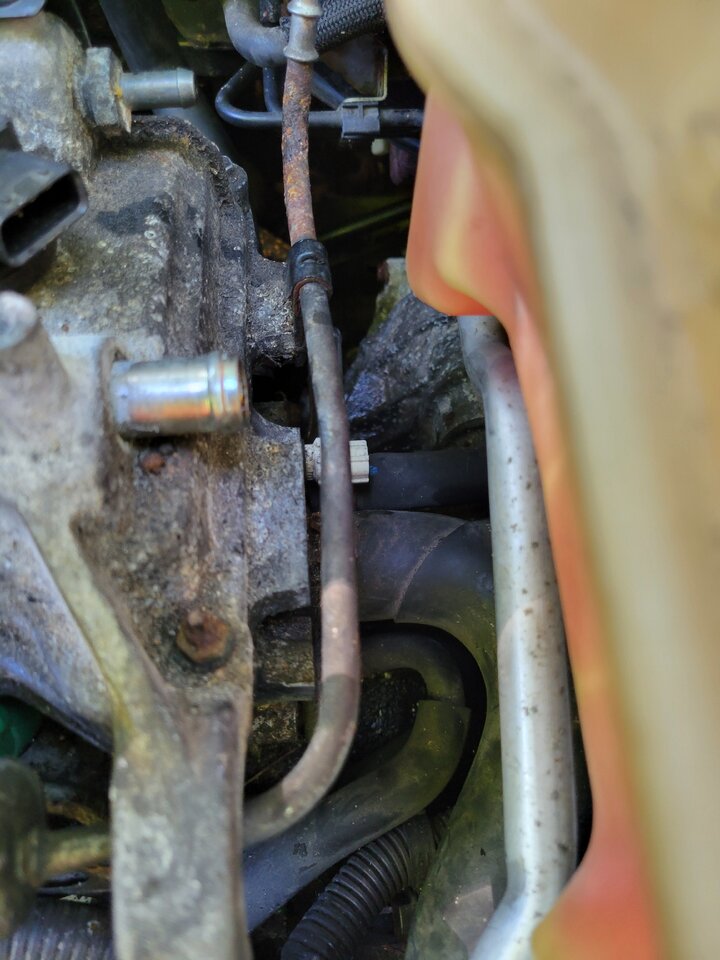

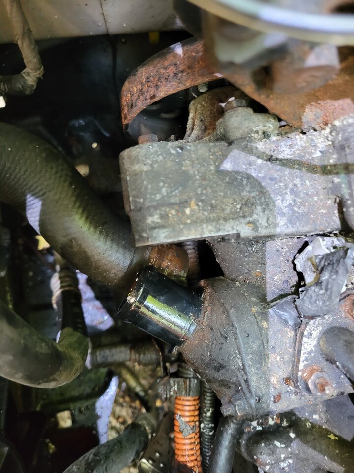

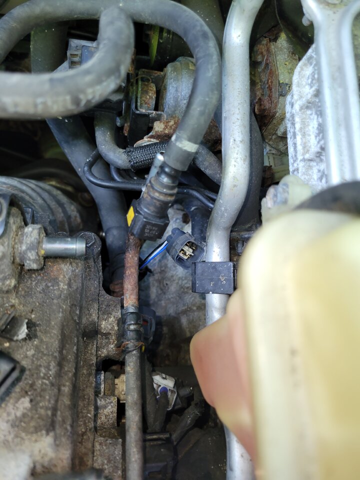

    1. Used a Dremel to cut clamp on the the front water line from the engine.
    Managed with minimal scoring

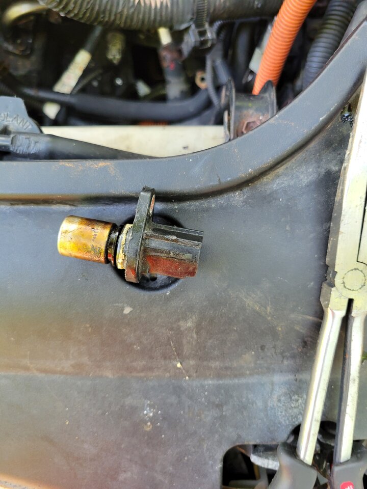

    2. Removed the crank sensor (I believe) from driver's side of engine
    Uses 19 mm socket. Was just a light turn in order to be able to remove it the rest of the way by hand.

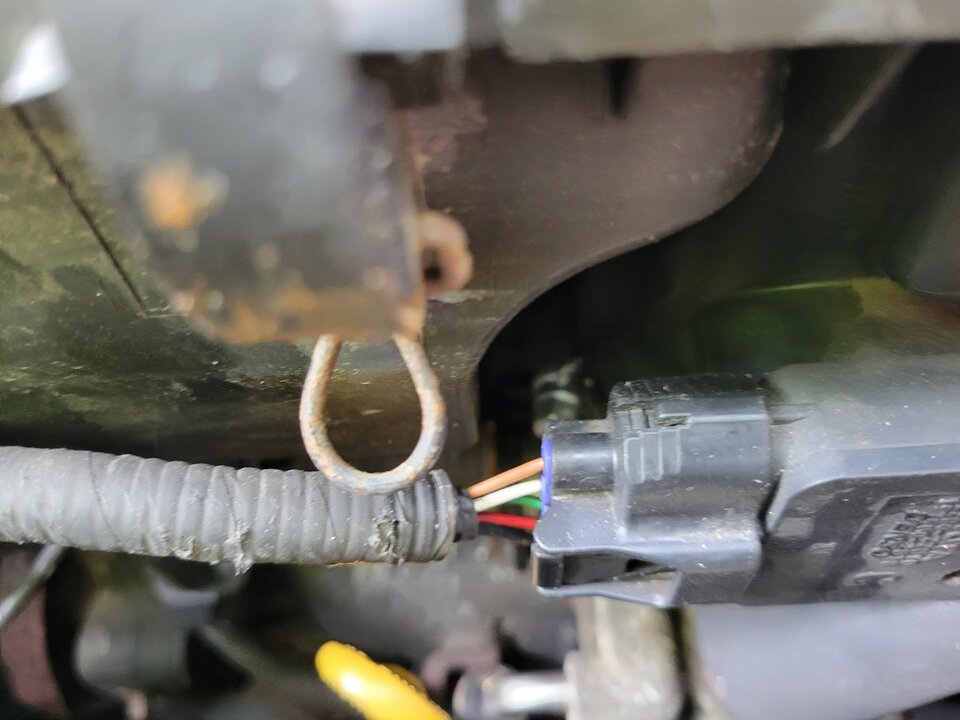

    3. Used long length needle nose pliers to turn the clam so it faced up and then used locking pliers to pull the hose clamp down.
    That lower pipe is very long

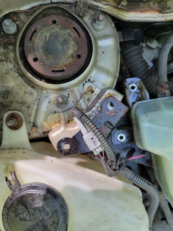

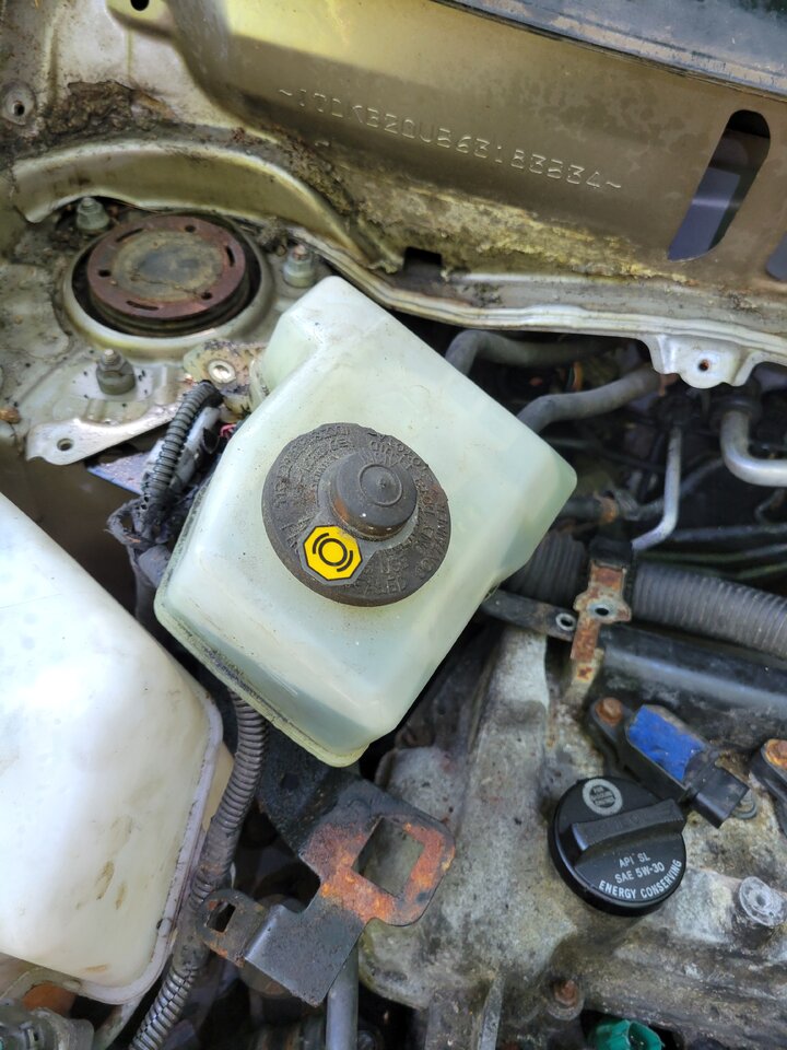

    4. Removed the bolts holding the brake reservoir on the engine.
    All 10 mm but needed a long extension to get to the one underneath.
    Did not disconnect the brake lines

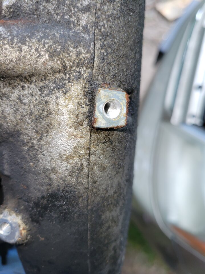

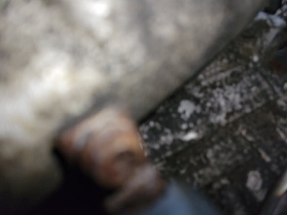

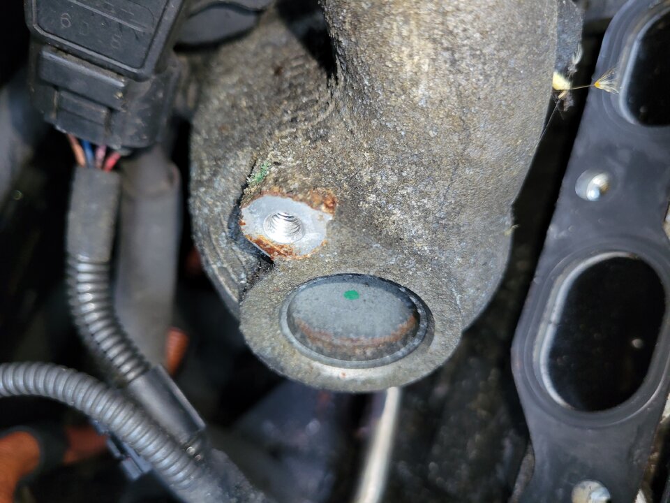

    4. Where disaster struck. Four 14 mm bolts holding engine to transmission
    Three came out with a bit of force but the up front one sheered off inside the engine part of the housing but recessed. Got a set of tools from Amazon to try to remove it which I will get Sunday. Should have sprayed that one bolt for like three days with PB blaster.
    Engine-transmission Housing Bolts-01.jpg Engine-transmission Housing Bolts-02.jpg
    The bolt in the second image is the one that sheered off.
    Have an alternate thought. Is the lower part of the engine of as Prius aluminum or steel? Maybe if I have to, I can break that part of the engine if I cannot get the bolt out? Then I can drill the bolt out easier in the transmission.
