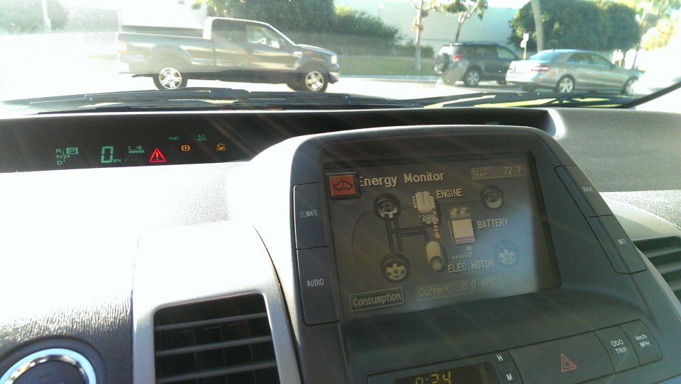

    Got in the car this morning to go to work and when I started it up, the hybrid battery indicator was at one bar (red). When I parked it yesterday evening, it was definitely higher, at least in the blue and above the halfway mark. I started driving it and it began recharging. When I came to a stop at a stoplight (probably about a 1/2 mile later), the battery was at green (one below fully charged). But then it went to fully charged (still at a complete stop) and the engine turned on. Now I've had this car for awhile, so at times, especially after a long downhill, the battery will go to fully charged and when I come to a stop, the engine will run a bit. But this time, there was no hill, and when the engine turned on, it sounded different.
    Anyway, I continued on and the charge came down to normal. About a mile later, as I was driving, I then noticed the charge dropping rapidly. Down to red. This was clearly abnormal, as I was on a level street, and not accelerating fast. So I pulled over into the next parking lot. I parked, shut it off, and then turned it back on. That's when the red exclamation triangle light came on, and the MFD indicated 'Problem.'
    I had it towed to the local dealership where they are checking it out now. My guess is the hybrid battery is having issues. Fortunately, I'm just under 145k, and the warranty is 10 years or 150k...so if it is the battery, looks like lucked out there.
    Will wait to see what the dealership says, but anyone else have this issue or know what may be wrong?
