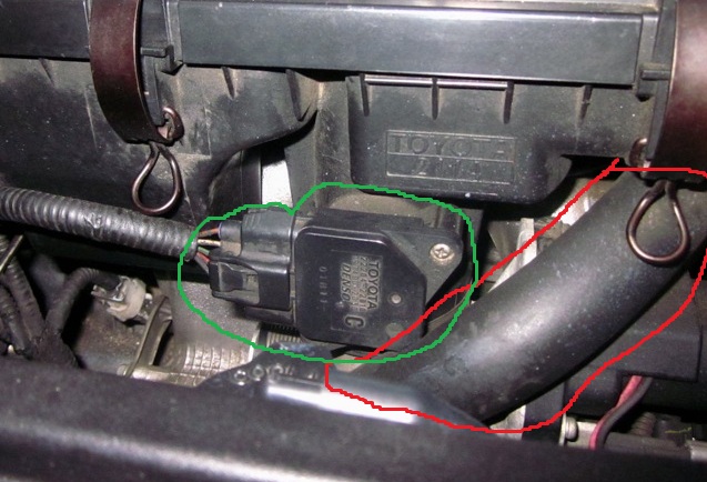

    In this picture, the MAF Sensor is circled in green while the pipe I am thinking about is circled in green. I think there is a second one next to it.

  9. MAX2
    MAX2 Senior Member
    Aug 12, 2024
    1,436
    490
    101
    Third planet from the Sun
    You can leave this for breakfast.:)
    The mass air flow sensor is attached to the air filter housing. If you remove the clamps and fasteners of the air filter and fold it aside, you will see the throttle valve and all the hoses that connect to the valve housing. The PCV hose is described separately in the manual for checking the P0171 code.
