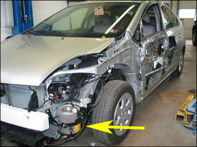

    You are hearing the engine coolant heat recovery pump and this is normal. This pump will frequently run when the car is first started and when it turns off. The purpose of the pump is to move hot coolant to and from the coolant heat recovery canister which is a thermos container that stores ~3-4 quarts of engine coolant. This is supposed to shorten engine warmup time, thus reducing emissions produced during warmup.
