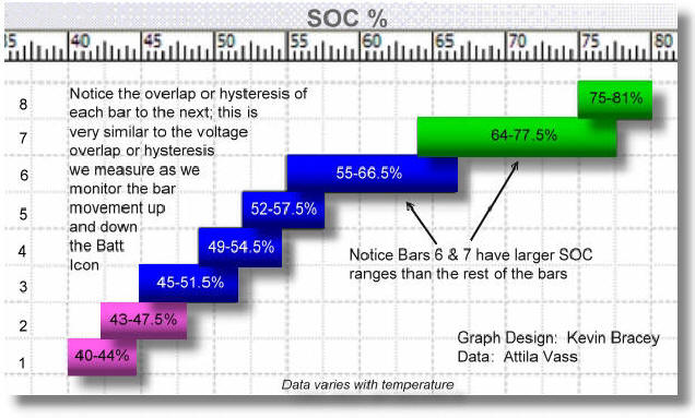

    Hi Chris. Your HV battery is showing some signs of aging, as are many others approaching 10 years old. Take heart though, my 2005 has had very similar symptoms to what you're describing for nearly 3 years now, and is still going fine. I'm currently at about 135k miles, and this issue has been noticeable to some extent for at least 40k miles now. Also, I have discovered that there several things that you can do to mitigate the issue and keep your Prius running well.
    Firstly, it's important to understand that it's very much normal (all Prius) to use the HV battery very heavily in the first few minutes. It's a combination of several factors (including high initial DC-DC converter load and also aircon compressor load, both of which that feed off the traction battery) but mostly due to the fact that the car tries to use electric propulsion in preference to engine power until the cats reach operating temperature.
    When your battery is new you may not notice this large amount of battery usage in the first few minutes because the SOC display is decidedly non linear, with 6th (and 7th) bars on the display being noticeably broader than the others (see attachment). Once you drop to the 5th bar or lower however, the amount of energy corresponding to each bar is much less, and this definitely gives the perception of much more rapid reduction in SOC (can almost feel like the battery is "collapsing" sometimes).
