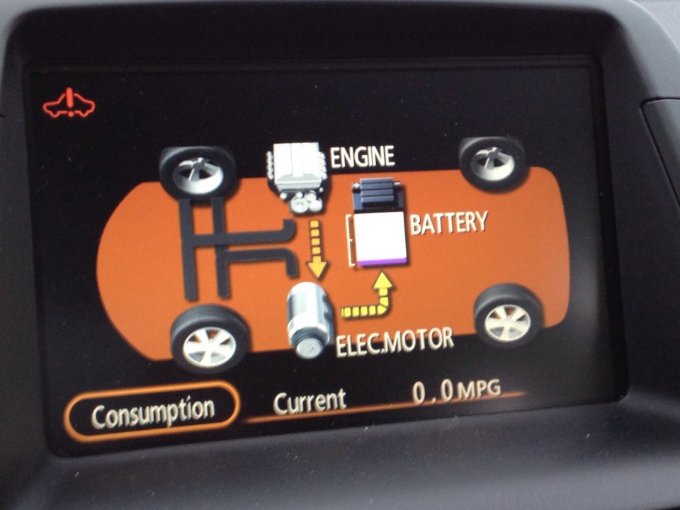

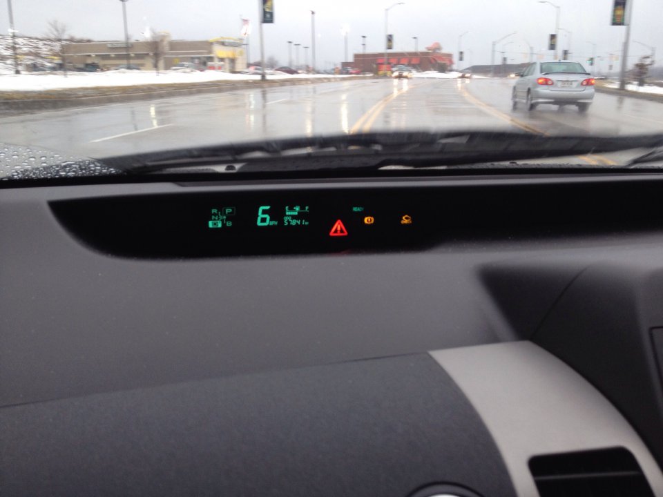

    My partner drove the Prius to work this morning as he always does. So he is on lunch and sent me a text saying some warning lights appeared on the dash while he was sitting at a red light. I asked if he had any loss of power, if the battery fan was running, he said it drove normally. We bought it last summer with 44,000 miles from a Toyota dealer. They said it had a new inverter pump. It has the original 12v battery however. Though it doesn't act weak at all. No issues this winter at all.
    Note, the battery in the photo is at 1 bar. I asked him about it and he said he was driving aggressively to work today, which includes a 2 mile 6% climb he said he made at a high rate of speed... Though after the exit, he has another mile to work.. So the battery should have built itself up before him parking it.
    His HV battery does act weird though after it's been fully charged. I think it's suffering from capacity loss. I won't be able to read the codes till he gets home tonight. Until then, any ideas?

    Yeah, it sounds like he ran the battery very low by driving aggressively and up a large hill. I'm betting if you put it in drive and hold your foot on the brake while giving it gas, you can charge it up to 6 bars and then shut it off and on 4 or 5 times and your problem will disappear.

    Original 12v battery in a 2006? Really?? 1 mile fully recharges the HV battery? REALLY? Think again. Get a new 12v. And plan on more time for HV recharge. Your are stressing the HV battery with the 6% grade at high speed.

    If y0u have equipment to read the codes, do so and there won't be any guess work. A HV battery failure or a failure of the inverter pump after 10,000 miles is possible. A weak 12v battery shouldn't cause the problems you are experiencing while it's on and in READY mode. If you haven't checked your oil level yet, it would be a good time to do so.

    I didn't say it would fully charge it, but build itself up from at least one bar to maybe 3 or 4 in a mile.
    At first I thought that maybe the warning lights appeared if he parked the car for 5 hours with one bar showing on the SOC. But I don't think that would be the case.

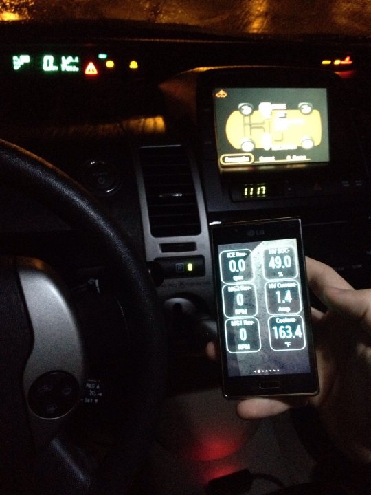

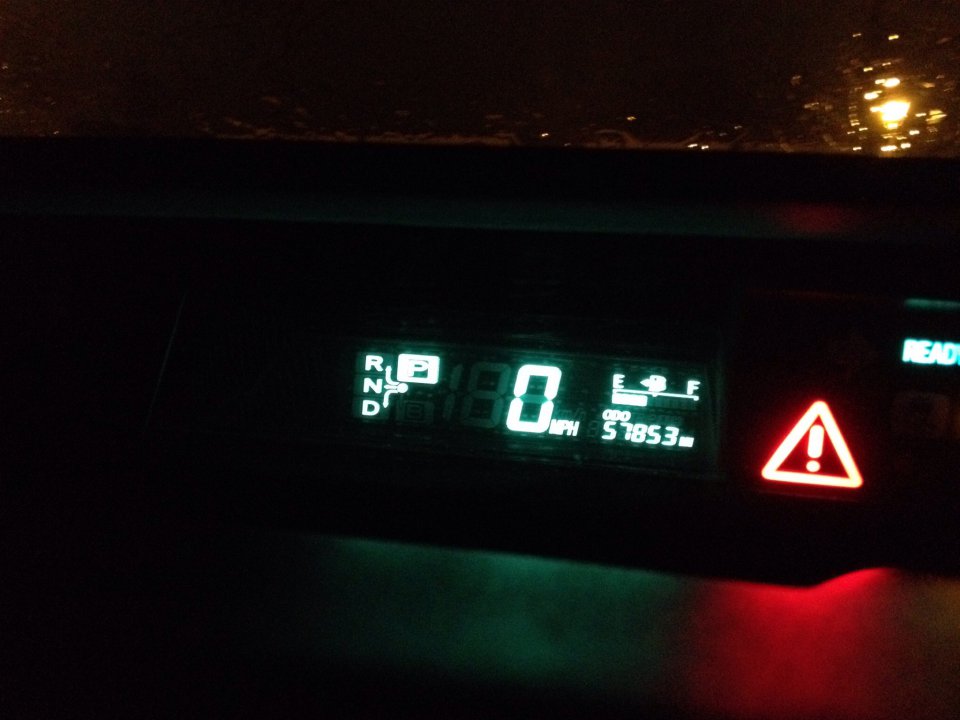

    Read the code. P0A80 which is hybrid battery failure. Calling Toyota tomorrow. When he arrived in the parking lot, the battery was full and the engine was revving highly, then it stopped, and the battery within 2 minutes fell to two pink bars.
    I've built a G2 Prius from the ground up before and installed packs, so I may go about this myself. I'll keep you all updated.
    Strange because the car was a one owner, in mint condition, no accidents, and we bought it used from a Toyota dealership last year with only 44,000 miles. It now only has 57,000 miles. Hopefully Toyota is helpful...

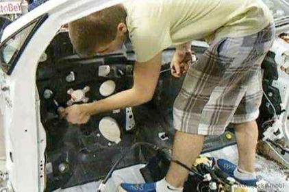

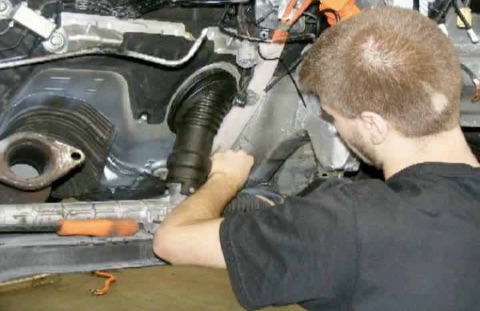

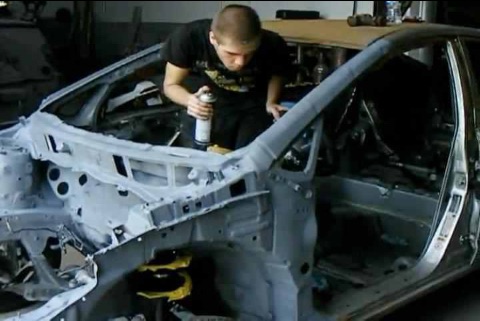

    BTW. I'm not aware of the circumstances that required it, but it looks like you did a nice job with the strip down and rebuild. :)

    I also have a reference number from Toyota that the service rep asked for. Made a video of how the battery acts too, I'll post it shortly. It drains down to two pink bars within 45 seconds and charges up to 4 blue bars within 10 seconds.
