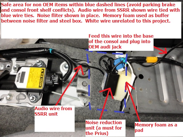

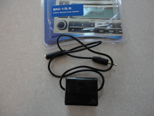

    I had the same problem with a Sirius Sat radio unit and my solution was a "filter" that is used on the line that plugs the Sat radio unit into the cars aux jack. I've attached 2 photos so I hope it shows up: DSC00667.JPG
  10. Logangogarty
    Logangogarty Junior Member
    Sep 25, 2013
    31
    This is perfect thank you !
