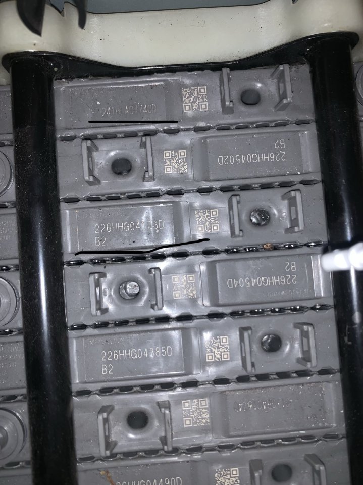

    Just for clarification, can you read me the manufacture date of these 2 underlined in black?

    I read 226H as June 22, 2006. Happy Birthday, battery!

    Leadfoot has the bottom module right. The top module is illegible.

    That square is called a QR code. You need a 2D capable reader. A standard bar code is considered 1D. There are apps for reading QR codes with Android phones.
